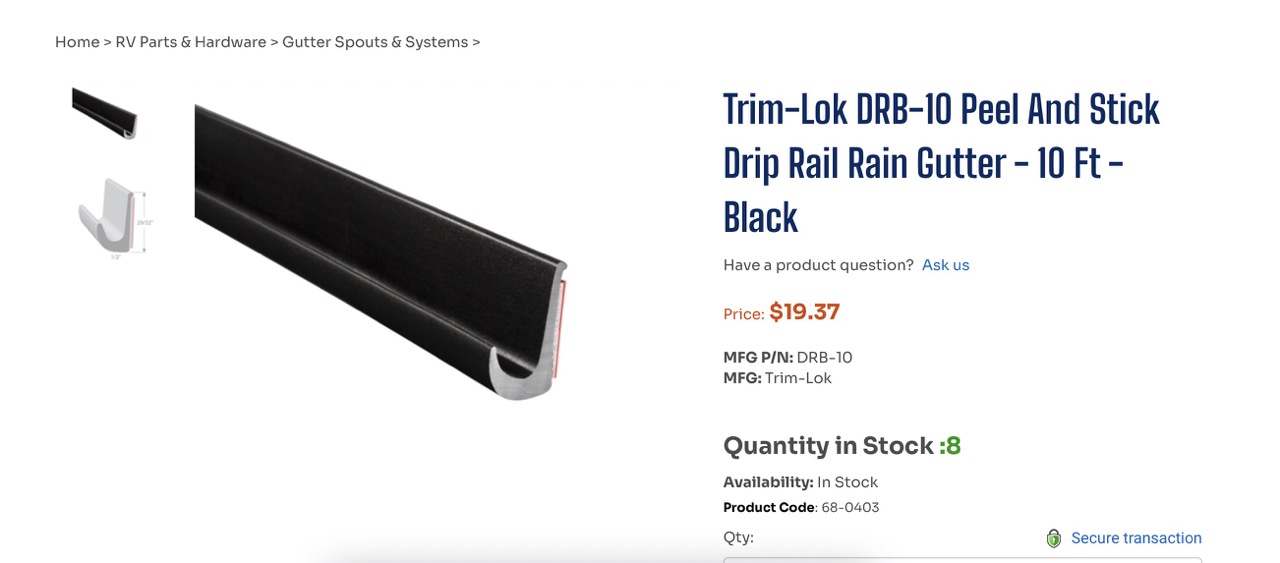

I did see this TrimLok black PVC drip cap that is flexible. Not sure how this would look or if it will work.... but would probably be easy to bend to the shape I'd like.

Postby Tom&Shelly » Tue May 10, 2022 7:10 pm
Hi John,
I have a few feet of that Trim-Lok J molding, except maybe mine is smaller: 1/2 inch tall by 3/8 inch wide. (Shelly tells me I was supposed to put ours on the bottom of our hatch, and she still wants it :NC )
Anyway, if the radius of bend is fairly large, it looks like it might work for you. Just eye-balling it, maybe a 4 inch radius max. But then, there may be some tricks like heating it or something that would make it bend easier.
174145 170466 173366

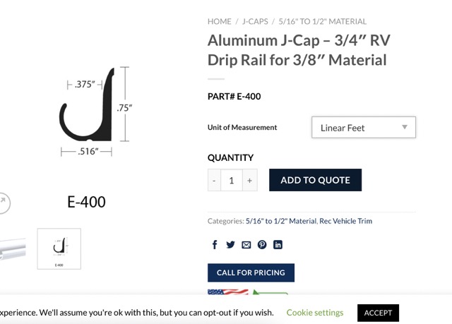

EDIT: Just saw this product from Eagle Aluminum. I'm finding the shipping costs to ship these long pieces is REALLY EXPENSIVE!!! :thumbdown:
