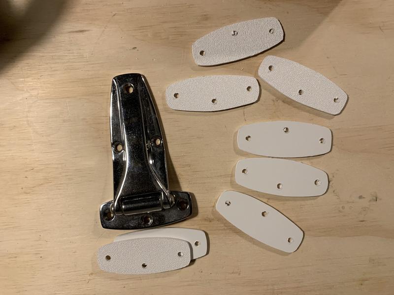

I used 1/8" thick nylon to shim my refrigerator-style hinges. I cut the nylon to fit the footprint of the teardrop side of the hinge. This moved the plane of the door out 1/8" from the plane of the teardrop sidewall to allow room for weather seals.

Thanks a lot Tom. I just went ahead and shimmed the cabin side like you did. If fact, your shims look exactly like my shims. And so do your hinges, probably the same from McMaster. I used black ABS I had for the shims. I think the door actually warped a bit as I'm gettin some unevenness ....like all the surfaces of the door moldings are not making contact with all the surfaces on the cabin moldings. I'm going to have to try some different weather gaskets/stripping combinations to make sure all is sealed and maybe have some secondary seals.

I did the same. I am pretty sure I got the idea from Tom’s build, too!
I stacked two shims under each hinge because that worked best with the foam thickness I could find for sealing the doors.
