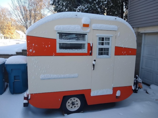

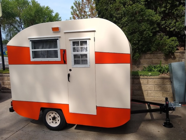

I agree with Sharon: if you are going to paint a wooden travel trailer you will end up doing some upkeep. Built both of mine from big-box store wood/plywood. Most recent one using mostly Home Depot wood. Coated (boat builders call it encapsulated) the thing in epoxy, sanded, another coat of epoxy, sanded and painted numerous coats of latex paint. Still, somehow, moisture gets in some places (I swear I paid especial attention to the end grain) and I have to sand and fill and paint. It sat outside all winter (Minnesota) which didn't help. I guess that is the price for using what I can afford. Looks great most of the time. Hoping to find some way to cover it or store it in a garage this winter. Better yet head south!
