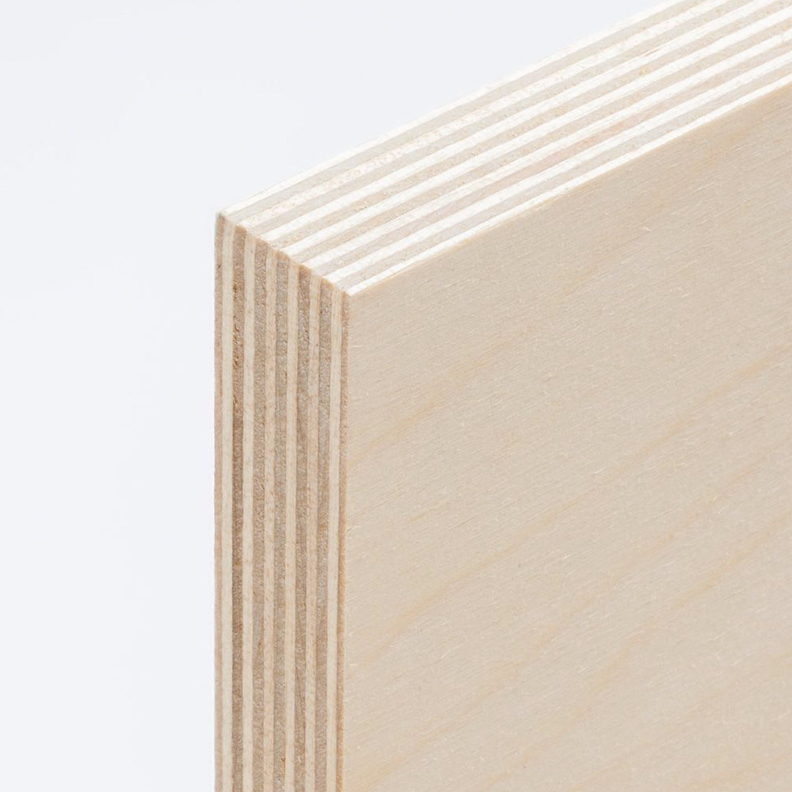

Other than price, marine plywood is fine. The stuff Danny is talking about is called ApplePly. It's actually made from birch, not apple wood. Most box-store birch plywoods probably have a very thin birch veneer so it's not what you want.
One of the great things about Baltic birch and (apparently) ApplePly is the number of laminations.
So when shopping for plywood, look at the number of laminations and how thick the exposed veneers are. AC and CDX plywoods are okay but a far cry from Baltic.
