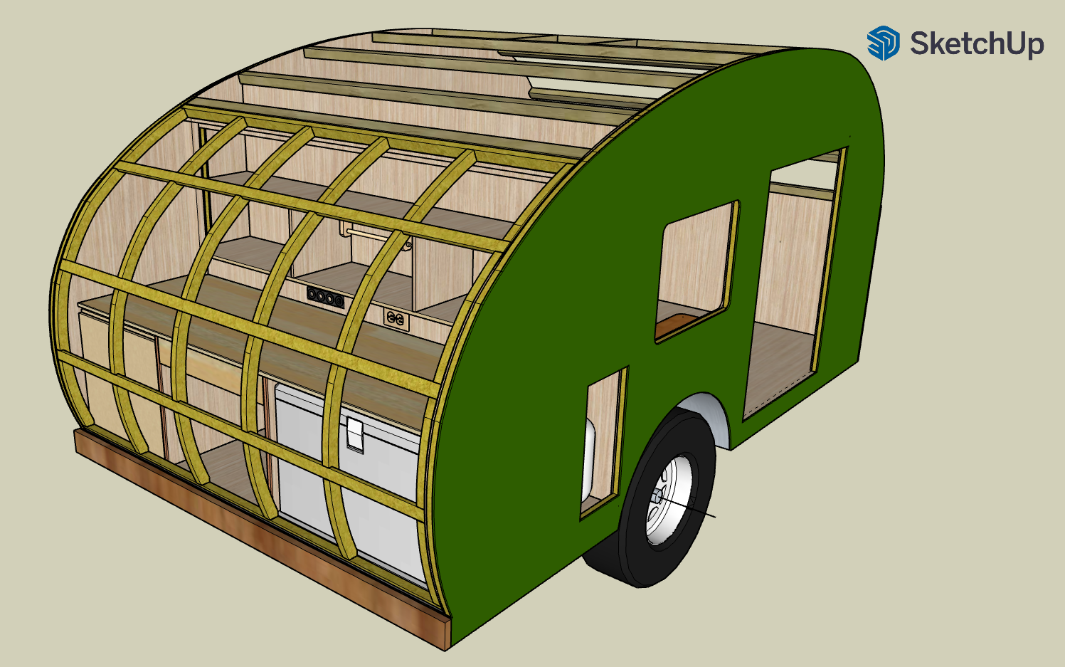

I am working on finalizing my galley hatch design and I am really struggling and second guessing myself on how best to seal it. As you could see from my build journal, I am getting close to building the walls. I need this important issue resolved before I proceed. I am moving in three months and need to have this contraption road worthy.
Here is what I have going on.
This is obviously the back of my trailer and the galley hatch frame. This is to give an overview of what I have designed.

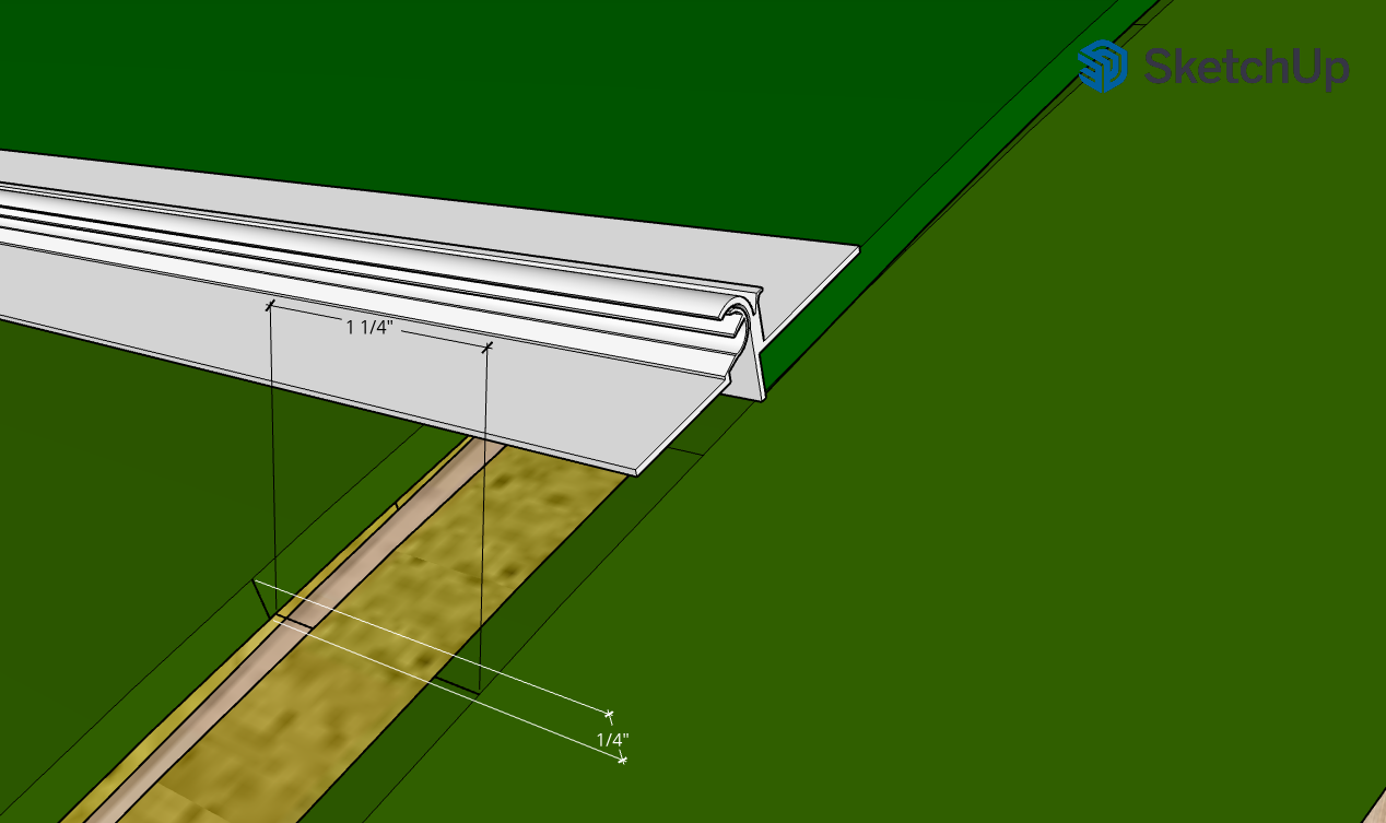

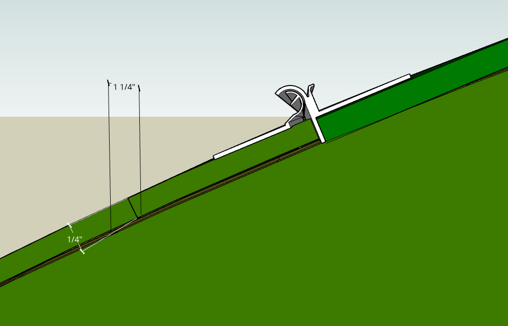

Here is a side view. As you can see I have only 1/4" of space for a seal. I am thinking about using the Vintage Technology extra wide T molding. https://www.teardroptrailerparts.com/rear-galley-door.html However, I not sure yet if I can get insert style moulding that is only 1/4"
T4 - G-Hatch Side Detail.png (33.12 KiB) Viewed 594 times
This is the way I would prefer to do it because this is what I have drawn and working with as far as inside galley dimensions. I tried a thinner wall at the galley only and that is doable but I am still left with only a 1/4" space to put the edge molding on. I thought about lowering the edge of the wall at the galley portion only but have not drawn that yet.
Also can trim like the HT-11 on this page be bent to follow the curve of my wall? https://www.teardroptrailerparts.com/hinges---aluminum-trim.html
Soooo, based on what you see, what do you thing my best options are?

But if I am reading this right, that would lift up my galley hatch and ruin the smooth transition between the main cabin roof and the galley hatch. Perhaps I should trim down the wall at the galley portion to make up for the difference in the edge molding? I have not found the dimensions of the edge molding as of yet.

BLTillson wrote:But if I am reading this right, that would lift up my galley hatch and ruin the smooth transition between the main cabin roof and the galley hatch. Perhaps I should trim down the wall at the galley portion to make up for the difference in the edge molding? I have not found the dimensions of the edge molding as of yet.
Yes, that would happen with the spacer. But at least the trim would look continuous, and it's arguable whether a 1/4 inch offset would even be perceptible.
It is also perfectly fine to trim down the side walls by 1/4 inch. It's done all the time by builders in this forum. But there will be a step in the trim. (If you are installing 1/8" plywood roof sheathing, keep in mind that this will bring your total notch height to 3/8")
