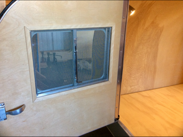

Another option is to use two pieces of 3/4” leg trim— one wrapping the inside wall and the other wrapping the outside wall. It’s twice as many sticks of trim (and screws!) but the finished appearance is nice with no raw plywood edges visible inside or out. My 1947 Kit reproduction has 1” composite walls and I use two pieces of 1/2” leg trim. Inevitably there will be small gaps in places and to disguise these visually I first run a strip of black Gorilla tape along the plywood edge before applying the trim. This method can be seen in the bottom of the image attached.
