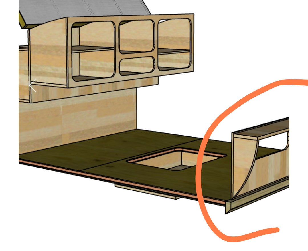

I was looking at you're design and was thinking about making the front of the TD (facing the vehicle) rounded. Then make that bulkhead begin at the seem floor/outerwall. And make a shelf there into the rounding of the wall. Like wandertears does
Is a rounded front any more difficult to build then the more flatter front you used?
It's not. But you'll lose a volume of storage area under the headboard. It's a question of form over function.
I put sliders under the headboard.
