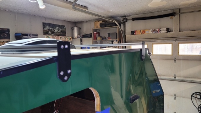

Postby Onajourney » Wed Feb 14, 2024 4:36 pm
I am very happy with the roof racks I made. They're extruded aluminum with T slots. I made the simple brackets out of 1x2 aluminum and made a 1/4 rubber spacer to clear the trim. Work great for mounting almost anything. I don't think I spent more than $80. Mounted the brackets, measured, then ordered the extruded aluminum to length. They're rock solid.

Postby Onajourney » Fri Feb 16, 2024 11:39 am
Pmullen503 wrote:Are those 20/20 (square) or 20/40 (rectangle) bars? Are they strong enough to put an 80 lb canoe on them?
Here is what I ordered from TNUTZ. They will cut to a 1/16" I was wrong about the cost. The 2 extrusions were $60 but also $40 in shipping. They definitely can hold a canoe. I have my awning, rod holder and large Pelican gear case mounted to it.

Re: roof rack bracket
Postby Pmullen503 » Fri Feb 16, 2024 4:39 pm

Great. Looks easier and cheaper than trying to put something together from Thule or Yakima parts.
