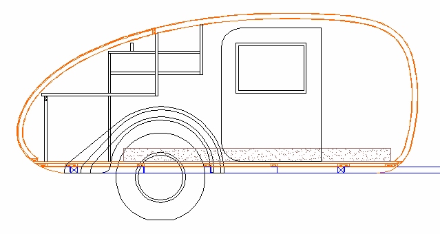

The side doors on most of the teardrops I've seen in pictures seem to have some "threshold" height (first picture - bottom of door not flush with the floor). Is there a reason for this? It seems that having it flush with the floor (second picture) would allow you to sweep out the teardrop easily. It also seems that you could sit in the teardrop with your legs hanging out without having the threshold dig into you legs. You also get a large door opening. Any opinions or comments?
Thanks,
Archie
4" Threshold
[img]http://www.tnttt.com/gallery/image.php?image_id=6490][/img]
Threshold flush with floor

The way I looked at it. I made my threshold height one half the thickness of the mattress. If it's a 4" mattress then make the threshold height 2". My mattress is 8" thick and my threshold height is 4" and I don't even feel it when sitting on the bed. With it not being flush with the floor, it also helps to keep bedding and such inside the tear and not hanging out the door. But if your looking for the rule. Build it the way you would like. In other words, there are no rules on how you build your doors. If you feel that it better suits you to build it flush then go for it.

Thanks for all of the replies. It sounds like about half the mattress height is the way to go.
