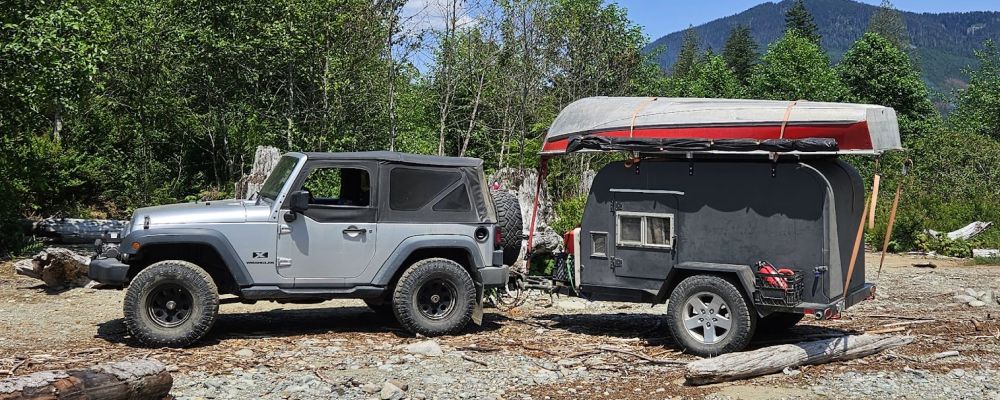

Long time TnTTT member, not an active poster. I built my first TD about 8 years ago. See images below if you're interested.

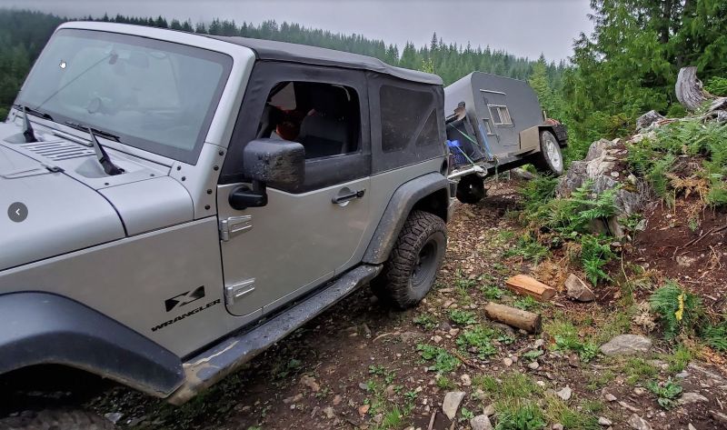

I've used my camper / trailer in many "Off-road" conditions. I know the term "off-road" means something different to everyone. My definition is if the jeep goes, the trailer should be able to go into 90% of the same places. I use this mostly on service roads, both maintained and unmaintained, and at times I'm breaking trail that has not been used in years, full of large rocks, washouts, etc. I have disconnected the trailer and winched it down steep hills, then back up on the way out. Not worried about scratches on the TV. However, I don't rock crawl unless I need to for some reason, and it's rare. It gets used in all four seasons, through ice and snow, sun and rain.

The trailer is 2x3 all around with angle inside, tow rings that have been used to both tie down the boat, and to pull the trailer out of a tight spot. All external surfaces can be stood on. Both the Jeep and the trailer share the same wheels.
The only issues I've had are the springs, I've broken 3 sets of 3500lb springs ( should probably go easier on some bumps), the last set of 3500lb springs was upgraded to have an overload spring and still broke (above). I'd go through one set every 2 years, approx. The last set I put on last year is now a 5000lb set. It's stiff! In the above lower image the spring is broken which is why the tire is close to the fender, it's being held together with a log under the axle and ratchet straps. Never had another problem.
The body is 3/4" marine ply walls, 2x4 floor framing (horizontal joists not vertical) with foam insulation. 1/2" bottom deck painted, edges are flex sealed, and a 1/4" ply top on the floor. The front wall is 2x2 framing with foam insulation. Exterior and interior roof / ceiling is 1/8" ply. All walls, roof, etc. are coated in resin. All seams are taped and glassed. All seams are rounded over, taped, glassed, and smoothed. It's then painted with exterior grade house paint which I reapply every 3 years or so.
Now, we're looking at building a new one. A nicer one.
I feel I did a good job on my current square/tear drop. But I know it can better.
