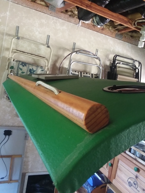

For my new Foamie, I'm seeking a good looking design, preferably homemade, hatch lift handle.
On my Woodie I used a chunk of stair railing. It is round with a flat on the bottom. I routed out two recesses in the flat portion, drilled rope sized holes in each end and then anchored the ends of the rope in the recess. It worked well and I might repeat that design but wondering if anyone can suggest a different design.
The ol' Woodie's hatch handle...
Tim

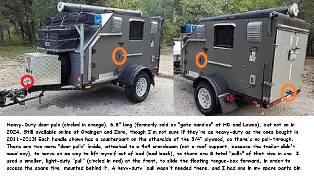

Postby working on it » Thu Jul 18, 2024 12:35 pm
steve cowan wrote:Used a metal outdoor gate handle with metal backer plate on inside.
VanIsledave wrote:We used a drawer pull from nearby orange hardware store
I used a lot of heavy-duty steel hardware in building my squareback trailer: galvanized angle brackets and corner braces inside, and black painted/powder-coated "gate" hinges, latches, and handles inside and outside. I'd grab some needed hardware from Home Depot or Lowes on my way from work or home, on my way to my friend's home race-car fabrication shop (where I was building the trailer secretly, for the first 11 months before bring it home to complete it, for another 11 months), as a surprise to the wife. If leaving work, it was 75 miles away, or if going there from home, it was 55 miles away. So, I was always secretly buying parts, and transporting them to the build site, in the back of my '09 Chevy HHR Panel (some parts were stored there for months, and she never noticed them).
P.S. after I showed her the trailer (built for her use on Bigfoot hunting trips with her friends...yes, she was a member of a BF group), she chose not to use it, due to her claustrophobia, and preferred her big tent. The trailer was for her safety and comfort, better than her tent for sure, but she still said no. Anyway, she never went camping again, and I took over the trailer as mine, alone!
Now, back to "HATCH LIFT HANDLES": I used two on each side of each door, and two opposite each other to lift up-or-down my simple hatch, and two inside, later, as a lifting aid to help me up in the morning (I have a bad back). They are very durable and strong, so they'll never bend or break (not even if Bigfoot yanked on one, hahaha), but the black ones just like them seem to have disappeared from the big box store (Lowes has a similar one, but it's not the same). Silver, galvanized handles are available there, but I could only locate similar black ones at Grainger https://www.grainger.com/product/Pull-Handle-Unthreaded-Through-1WAE5?opr=PLADS&analytics=FM%3APLA&a2c_sku_original=1WAD7&position=3
and Zoro https://www.zoro.com/zoro-select-heavy-duty-door-pull-steel-6-12-in-l-zinc-unthr-holes-1wae5/i/G2293584/?utm_source=google&utm_medium=surfaces&utm_campaign=shopping%20feed&utm_content=free%20google%20shopping%20clicks&campaignid=17863415718&productid=G2293584&v=&gad_source=1&gclid=Cj0KCQjw-uK0BhC0ARIsANQtgGMRQHLMQXmHs86UncEqlRRCAGCua5AUVglfao0IfTkCxOOsjRdQbU0aAqEeEALw_wcB&gclsrc=aw.ds
