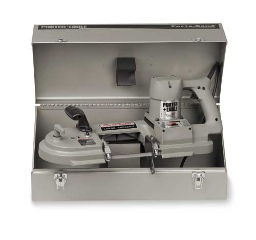

Postby bledsoe3 » Tue Mar 21, 2006 6:11 am

Postby PaulC » Tue Mar 21, 2006 6:17 am
Thanks bledsoe(Steve?) Looks nifty. We don't have anything like that over here. How versatile is it?

Postby Larwyn » Tue Mar 21, 2006 7:12 am
The portaband is a portable band saw. They are usually sized to cut 4" pipe or tubing, often used for cutting conduit. Being a hand held tool they are versitle as far as angle cuts and such go. You can cut solid stock up to whatever size you can fit between the blade guides if you are careful about feed rate, realistically I have cut 4" chanel iron, and lots of 1.5" angle and solid round and square stock up 1". With it you can make all manner of freehand cuts. Accuracy of cut is directly related to how carefully you feed the saw.
