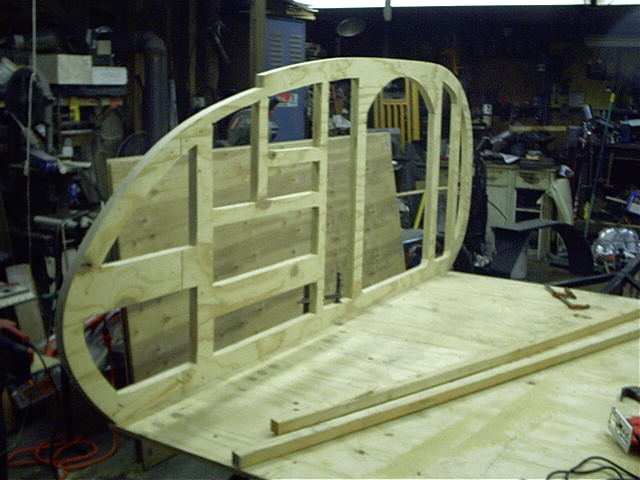

molethai wrote:Has anyone looked into and/or tryed using plywood for framing?
Mole
I've started a plywood framed Widget...
The first thing I noticed is that it's very heavy.
Also since it's 1/32" smaller than the 3/4" insulation that I want to fit in there, I'm afraid I won't get a good bond between the framing and the skin.
That's about all I have to offer at this point in time...
Postby Chris C » Sat Mar 18, 2006 11:49 am
Mike,
THAT's the picture I wanted to show him. l think that is the better solution. No joints to have to try and match perfectly. As far as the plywood being thinner, I just plan to use a more efficient insulation, (in my opinion) the foil and bubble material. It's not rigid and shouldn't pose a problem with the difference in plywood thickness.

That's the way I did mine. I used 3/4" ply and removed everything I didn't need. I thought it was going to be heavy but after I got it all cut out I found it wasn't bad at all. It also makes things go a lot quicker.
I also came to the conclusion that with a little more planning I could have cut it down more and eliminated a little weight. But my plans kept changing as I built it so I wanted to make sure I had a bit of a fudge factor for my mount points.
Mole
Very nice looking frame Mike. :thumbsup: If you want to regain that 1/32" you might look for regrind plam. Regrind is left over plastic laminate that the mfrs like Formica & Wilsonart regrind the good side of plam. Cabinet shops use it for backer sheets. It glues very well on both sides. :) On my tear the Popular lumber was 31/32" thick so I ran the pink foam down in my wide belt sander. That stuff melts easily as I would find almost pencil sized melted scraps at the end of a run. Danny

Postby Classic Finn » Tue Nov 21, 2006 4:28 am
Mike that framing looks real sweet.... but then again you knew that... 8) 8) :thumbsup: :thumbsup:
