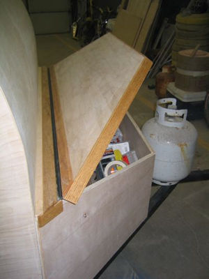

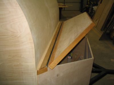

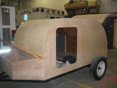

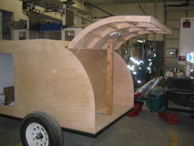

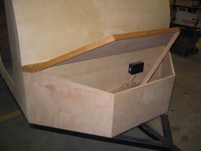

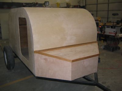

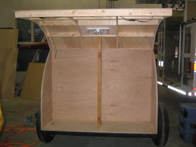

Sorry I have been away for so long. I have made some new progress though. Here are a few pictures. (you will have to be logged in to see them though I believe)
It has been dubbed "Stumptown" after the historical name of the town I live in here in Montana.
Fenders are backorderd and windows are about 2 weeks out. I figure I should be complete in 4 to 6 weeks!!!!!! Then it's fishin time!!!!
Dont F*ck with Mr Yuck!!!

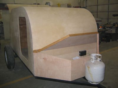

Postby bledsoe3 » Tue Apr 11, 2006 2:09 am
Looking good! I really like the tongue box. :thumbsup:

Postby Ira » Tue Apr 11, 2006 7:21 am
NICE!!!
(How the heck do these guys build them so fast?)
By the way--how the heck is that LP tank fastened?

Postby neal b » Tue Apr 11, 2006 7:39 am
looks great i like the box up front ought to hold alot of stuff :thumbsup:

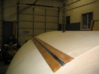

Postby madjack » Tue Apr 11, 2006 8:05 am
...thanks for the pics...ya know we do luv 'em...looking good, how about more details on your hatch hinge ...... 8)

Postby Miriam C. » Tue Apr 11, 2006 10:04 am
Ezbie
Looking good. What kind of trim are you using on the hinges?

Postby sHoootR » Tue Apr 11, 2006 3:30 pm
Really lookin nice Ezbie,but as madjack said more info on hatch hinge? Is that a poly hinge?

Postby ezbie » Tue Apr 11, 2006 10:23 pm
Ira wrote:By the way--how the heck is that LP tank fastened?
It's not fastened right now!!! It's just sitting there...

Postby ezbie » Tue Apr 11, 2006 10:36 pm
madjack wrote:...thanks for the pics...ya know we do luv 'em...looking good, how about more details on your hatch hinge ...... 8)
sHoootR wrote:Really lookin nice Ezbie,but as madjack said more info on hatch hinge? Is that a poly hinge?
Lookin Good :thumbsup: :applause: :thumbsup:
The hinge is a Monroe Living Hinge (Plastic Piano Hinge) http://www.monroeengineering.com/hinges/living-hinge-plastic-piano-hinge.htmo ordered from http://www.mcmaster.com
It has been trimed with oak counter top trim with a 3/8 inch x 1/8 groove routered on the bottom an a 1/8 round-over on the top. I did the same thing for the toung box but did make a little mistake here. I cut the hinge 1/2 to short because I forgot to account for the 1/4 trim on the box but should be ok though. I will know better next time!!!!
Any more questions ask away... Love answering them!!!
