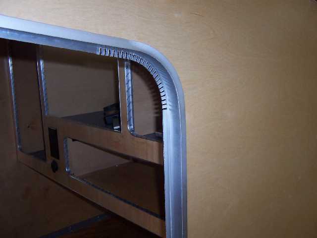

What do you use to cap or cover the door opennings after you skin the sides in aluimiunum.

...we used 2 pieces of 1.25x.25 angle to form a "Z", with trim seal on the inside............................. 8)

Your's was the one I was looking at Madjack, I like that. Now that my wood supplier is not going to carrie the 4x10 sheets any more i have to piece two sheets of ply to get my length. So I figure to cover the sides to hide the butt with alumiunum.
