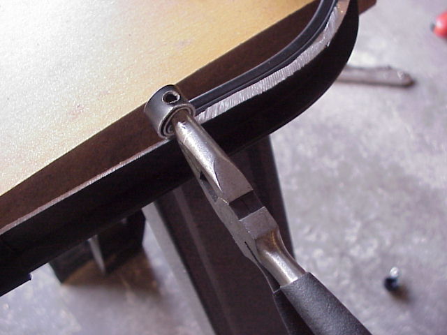

Postby Darren » Sun Apr 30, 2006 9:33 pm
Thought I would share what I learned today about cutting aluminum window trim. I ordered the 1 1/4" door thickness trim and later decided to go with a 3/4" thick door. What worked best for me was to use the angle gringer at 45 deg on the edge and then peel the flange off like a sardine can.

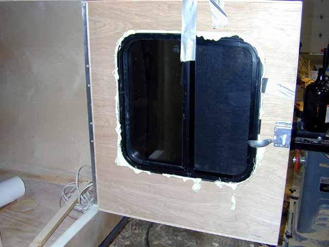

Postby madjack » Sun Apr 30, 2006 10:32 pm
without the interior clamp ring I wouldn't trust any adhesive in the long run to hold up...we used auto urethane windshield adhesive and screws on ours...after installation, we went back and painted the screw heads black...basically they disappeared with the paint on them...

Postby Artificer » Mon May 01, 2006 5:37 pm
I used Great Stuff to secure my windows in the doors. My doors are 1 3/4" thick, so it provides a bit of bearing surface. I've "temporarily" fastened a headlight on our commuter car after an accident. 2 years, and it still is as good as the day I did it. (184k miles... I'm not spending a lot of time on fixing the car)
I couldn't tell how thick your doors are. If they're too thin, this method isn't the best to use.

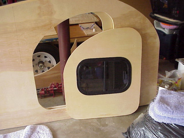

Postby cubby_1969 » Thu May 04, 2006 4:01 pm
I installed my windows with 2 screws on top and 2 on the bottom inside the jam I'll paint these so they won't show too much, and since they are in the jam you already don't see them unless you're looking for them.
