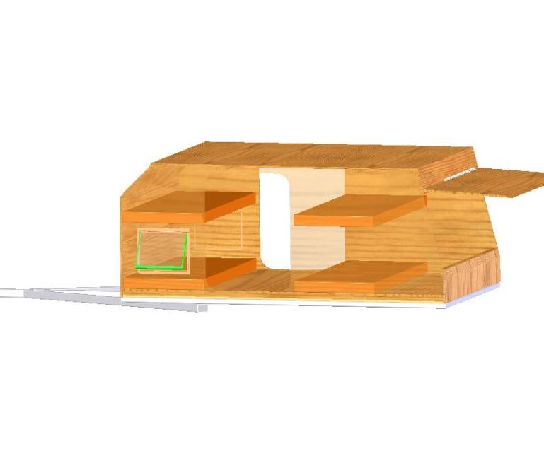

Postby gager2002 » Fri May 05, 2006 4:17 pm
Ok this is my first idea, but I think I need taller. Maybe 6' inside height.

Postby Chef » Fri May 05, 2006 8:27 pm
gager2002 wrote:Ok this is my first idea, but I think I need taller. Maybe 6' inside height.
Just a thought but if you are 6' wide x 10' long x 6' high on your interior demensions maybe you should just outfit a standard cargo trailer (which I have seen done) rather than starting from scratch?
