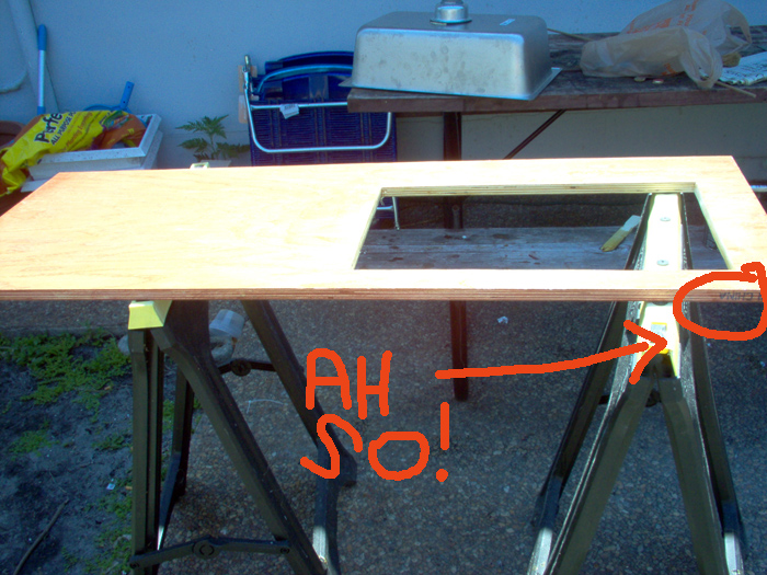

This past weekend, I cut my countertop and the sink fits in there like a glove. It's been stained and varnished since this photo was taken, but anyway, note my sincere kudos to the magnificent Chinese lumber industry:
I'm considering something which may not at all be possible due to my skills and the tools I own, and I have a friend who IS skilled and may be able to help me, but you guys first:
That's 3/4" red oak ply. What would it take to route out a section say 12" by 20", 1/4" deep, and laying ceramic tile in there?
Have I TOTALLY lost my mind here?
