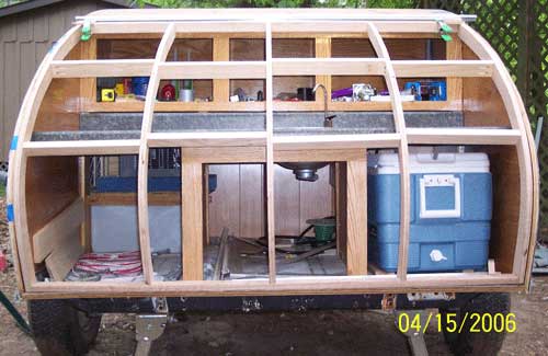

Bruce, I'm happy with mine. I've been using it all week while I finish the inside wireing. It's been in the upper 80's to low 90's all week. I'm also running it off a 1K genset. The small size allowed me to mount it under the counter.
You can see it on top of the watertank on the left.

That's the way I thought of it. a 2kw Genset was almost twice as expensive. I really shopped for the petcool. I got it on ebay for $329 brand new. I built it in because towing with a CJ-7 there's not alot of room in the tow. the 1kw fits under the counter.
