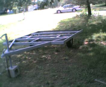

I finally got all the rust gone and the primer on. Now with no hail storms or any other crazy weather I may get moving. Unfortunately the paint I really want requires a 85 mile round trip and I am not sure how much to buy. :thinking:

Postby Miriam C. » Wed May 31, 2006 8:54 am
:) Thanks for the encouragement Brwbier and Paul.
Your probably right about the paint amount. Won't be enough. I have decided to paint something less flamboyant and more accessable.
We got the new shackels on the springs and now have 2" clearance for the wheels. What a job that was. Don't try this at home girls unless you have a compressor or a really strong someone to help. 100# of torgue.
If we had to do it again I would turn it over and use a really long cheater bar. That or hit the bolt with a hammer then put the nut on.
:cry: It is raining again so finishing the paint won't work. Can I put a floor on without painting?
perhaps some fishing! :thinking:
Miriam

Postby Chris C » Wed May 31, 2006 5:34 pm
Looks nice, Miriam. Keep going! :lol:

Re: Finally, work done
Postby Joanne » Wed May 31, 2006 8:16 pm
Miriam,
You've got a great start with that frame! One milestone down. I always enjoy reaching significant points in the building process. It helps me keep from getting discouraged about my progress. As silly as it sounds, when I feel like I'm not getting anywhere I go back through my website and look at all the progress pictures. It quickly brings back to mind just how much work I've already done. Another couple of years and I'll have her all wrapped up! :lol: :lol:
We may be outnumbered, but I think us ladies are making a strong showing! :thumbsup:
Joanne
Miriam C. wrote:I finally got all the rust gone and the primer on. Now with no hail storms or any other crazy weather I may get moving. Unfortunately the paint I really want requires a 85 mile round trip and I am not sure how much to buy. :thinking:

Postby Miriam C. » Wed May 31, 2006 8:39 pm
Joanne
Joanne when I look at the work you and the others have done it is encouraging. I really would have had a harder time putting the shackles on alone. Mike is strong enough to make it look easy but I tried myself and could only get a few turns. Afraid the welder would have had to do it. (He has a compressor.)
Guys where would we be with out you? ;) I resisted all day going ahead with the paint inspite of the humidity and rain. It rained so hard here my daughter in law got nervious and we live on a hill. :roll: didn't rain in Joplin at all.
I will visit my paint shop and get something that doesn't care about humidity and paint in the garage. Hang a lot of plastic, get masks and goggles. NO Pictures!!!! :lol: Don't wanna scare anyone.
Miriam

Postby Miriam C. » Sun Jun 04, 2006 7:09 pm
:D The paint is on!!! :thumbsup:
Well I got all the rust gone. 2 coats of primer and three coats of low gloss black paint. :roll: I know black is a cop out but we couldn't decide on a color we both liked so we compromised. (thats like not getting what ya want, but being ok with it.) :lol: What I wanted was $557 a quart. Duh!!
The other was 50 a quart and Mike didn't want Rasberry. Can't imagine why not.
The 12v wires are on and cheappy lights are working. Have to rewire the van cause the wires are old.
There is one issue- the blinkers both blink if the lights are on and either turn signal is flipped. Don't think it is a trailer issue (unless the cheapy lights). Any ideas welcome.
Now if it will stop raining I can go get my wood.
Have a great evening.
Miriam
