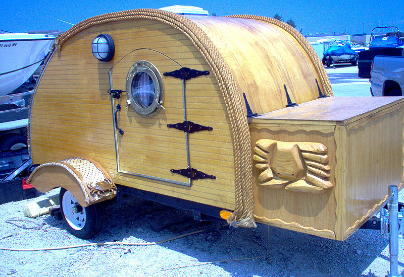

You have to trust me that the other side looks just like this one. I couldn't see the point of posting photos of BOTH sides.
It wasn't all that easy mounting them, but things nontheless went remarkably smoothly--which is a first for me.
The jack didn't even slip out from under the trailer and crush my legs or anything!
I made my holes in the fender side, got it into position, marked one spot on the TD wall, inserted a hanger bolt (real easy using 2 nuts, a wing-nut and pliers), and placed the fender in position. I then did the same thing for the next 4 bolts, one at a time, making it easy to match up the bolts with the holes. Then just popped on the washers and wing nuts and tightened with the pliers.
So where's the aggravation?
The tires look WAY too wimpy with these monster fenders, and now I have to make special wheel covers--moon caps won't cut it either. Here's the plan, but do you think it will work?
What if I epoxied 5 tee-nuts to the wheel, then took a ship's wheel and drilled holes into it, and secured it into the tee-nuts? (Am I saying the right thing--tee nut?)
Roly once explained how he did his, but not only don't I remember what he said, at the time, I didn't understand what the heck he was tallking about.
Here we go again!

I can't help you with your problem, but let me say that's one salty looking teardrop! Really looks great and you've done a super job putting it all together. :applause: :thumbsup:

Ira - Very nice work. I would be a little worried about the wheel balance using a ships wheel plus wouldn't you be able to see the white wheel through the spokes?. I'm sure it could be done though. My thought is to have someone with a lathe make some baby moons out of wood and then you could decorate them to your style. Attachment would still be a problem, the only idea I have for that would be to install longer bolts on the hubs. Then you could put the wheel on securly and have some type of stand-offs, maybe conduit cut to length, and then bolt the cover onto the same bolts. Just an idea.

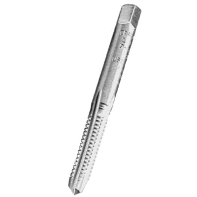

Thanks, Jack. But what exactly is a tap thread? Like, one end accepts a bolt, but does the other end just screw into your hole, or is it secured in a different way?

Ira, a tap is a tool used to make threads inna hole...you drill a hole, twist a tap into it, which cuts threads in the hole...remove the tap and now you have a hole with threads in it, which can be used with a regular bolt to attach something to the wheel...
madjack 8)
p.s. here is a pic of a tap used for a 7/16 hole borrowed from the Sears Craftsman website

How do you turn the tap?

...as you will notice in the pic that the top of the tap is squared off...they make a specific wrench that is a "T" handle, which will adjust to fit that square end. However, for what you are wanting to do a Cresent wrench will work also
