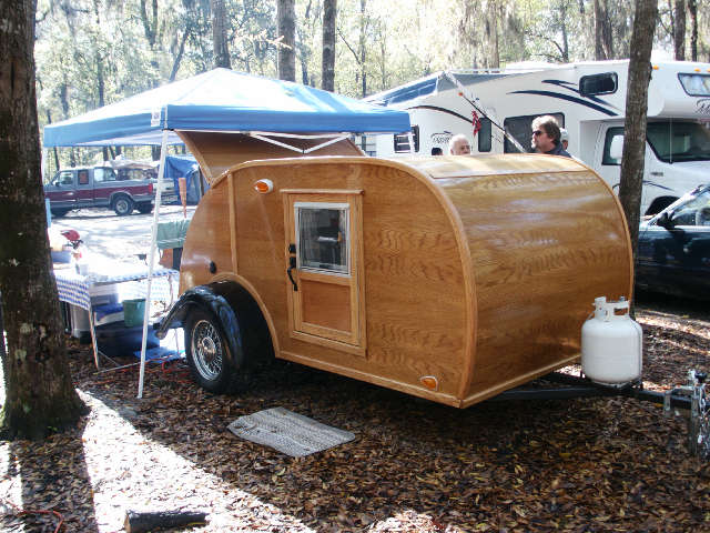

I wouldn't worry about filling if you have the high spots sanded off. What I would worry about is keeping moisture from under the outer skin of 1/8" oak ply. What I did when I skined my TD with oak plywood was glue it together with epoxy. It keeps out moisture and I didn't use any screws, nails or other fasteners. It doesn't take a lot of epoxy and it rolls on very easy. Anyway, it worked for me.

Thanks Steve, Your teardrop looks great. Exactly what type of epoxy did you use?

Postby Steve_Cox » Fri Jun 09, 2006 12:48 pm
mfkaplan wrote:Thanks Steve, Your teardrop looks great. Exactly what type of epoxy did you use?
Mary and Mom's Nest :thumbsup:
Thank you too :D
I used this stuff. It is $$$ but goes a long way.
