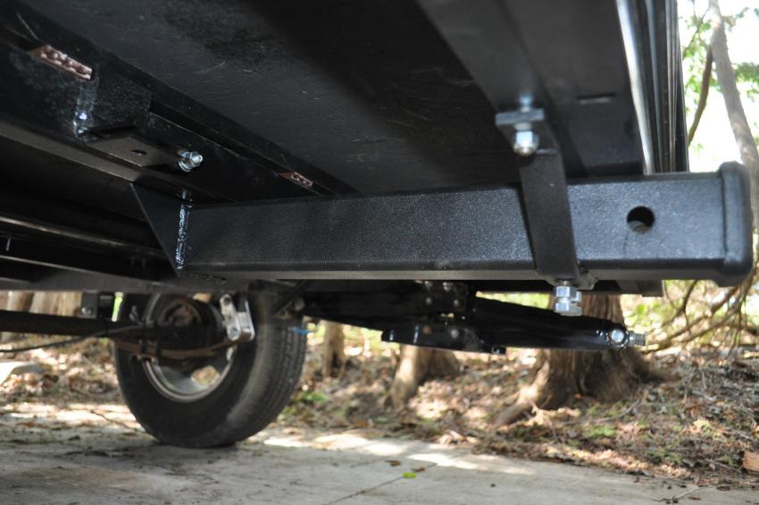

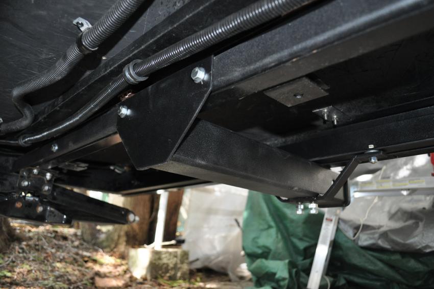

I posted pics of a 2" rear receiver tube tube I added to mine. Unfortunately all of my pics in this thread have been deleted as the site that hosted them changed its format. I will try to replace them in this thread but I don't find this forum to be the easiest to work with when it comes to posting pics.
EDIT - And, yes, I removed the rear steps. It was necessary to fit the receiver and it cut the weight by 16.5 lbs. We use a plastic step instead.

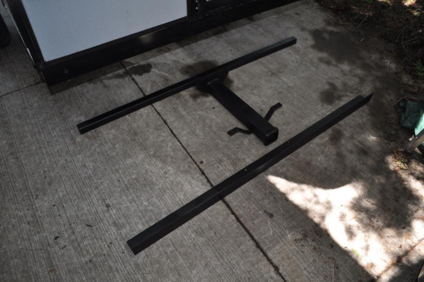

I added a hitch receiver to my Clipper. As mentioned above I had to remove the rear steps. I use the receiver mainly for a t-bar for my kayak rack. I also built it to reinforce the frame.
