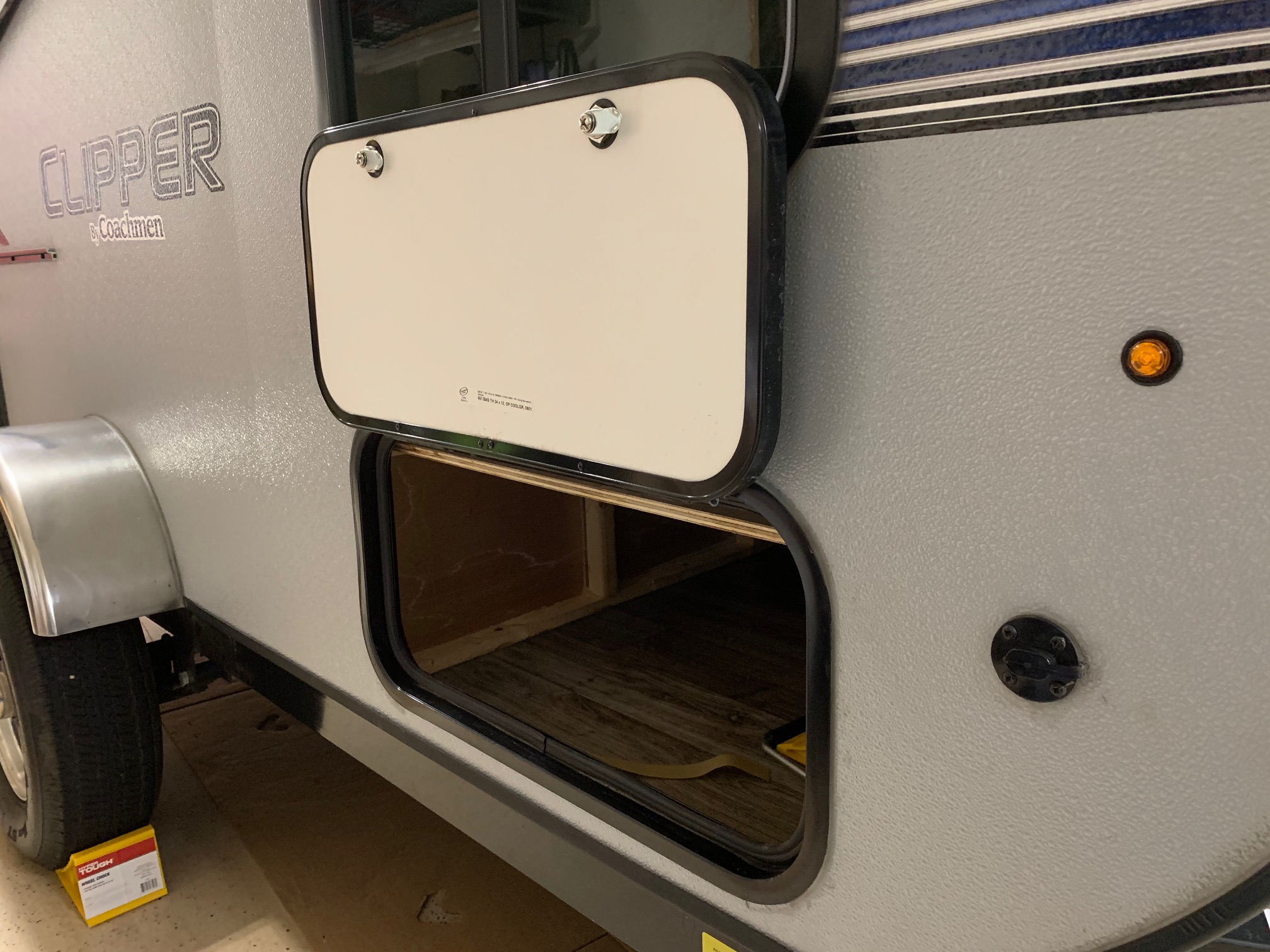

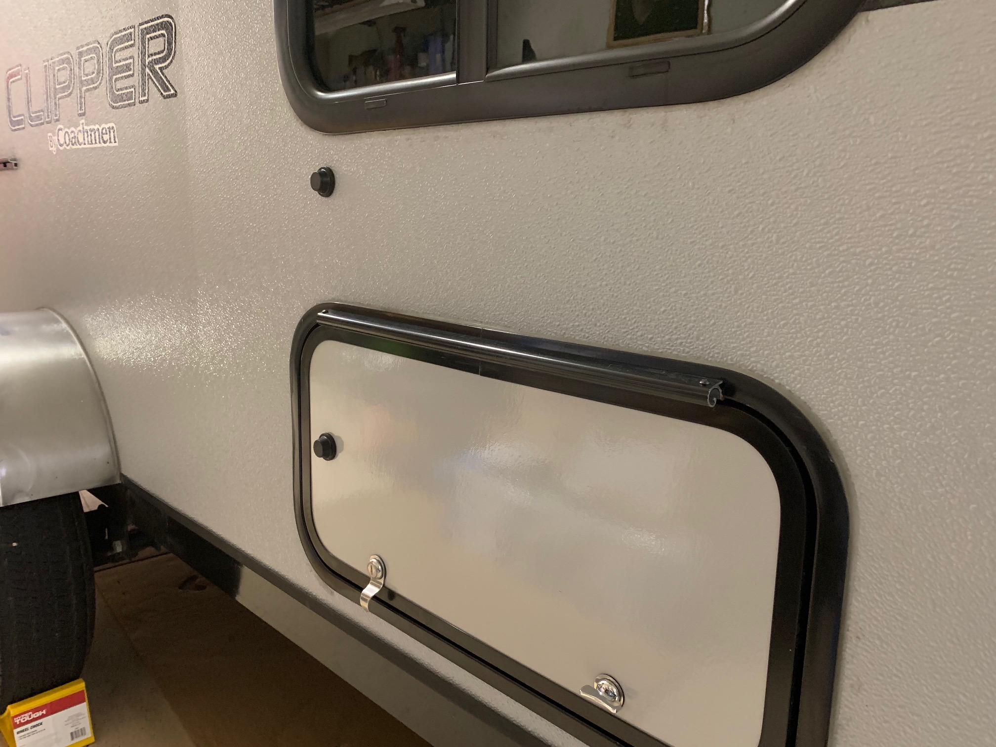

Back to the Clipper. I added magnetic door hold opens. One for the storage pass through and one on the entry door. What a difference.
They are stuck on with 3M tape.

Great idea on the magnets. I was looking at some 2 piece clips but those are a lot cleaner looking and would probably hold up better. Do you have a link for the ones that you used?

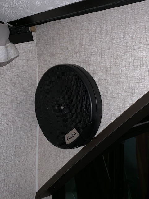

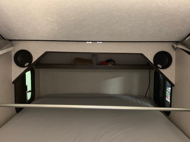

After spending 5 days camping at the beach over the 4th of July holiday, I realized the trailer needed a couple of upgrades. Yesterday I swapped out the speakers. Because of the shallow depth of the wall, I had to use spacers. They are in at an angle because the factory speakers are mounted at a 45 degree angle or so. They did that so 2 of the screws would hit the 1x wood in the wall and not just attach to the fiberboard. That little swap made a huge difference. :thumbsup: Whizzer cones just don't compare to a coaxial.

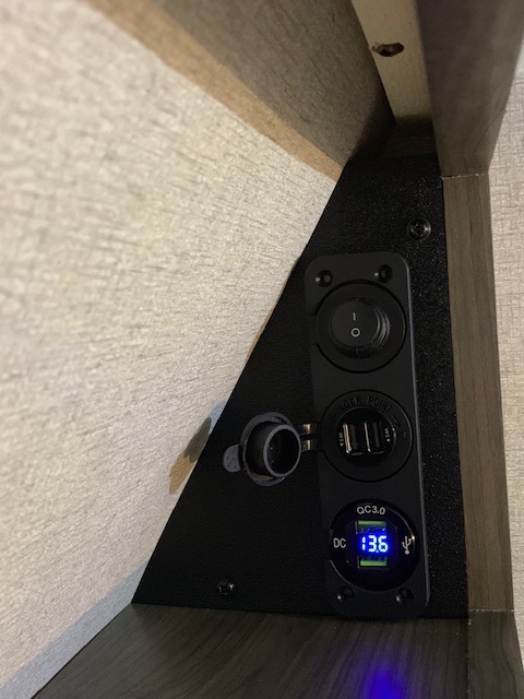

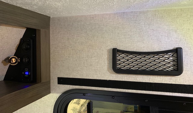

I also added a 12 volt charging station to the passenger side of the headboard. The factory location of the USB ports couldn't be worse. If you lift the bed for storage you hit the usb cables in the charger, plus at night your sheets or feet end up hitting the cables. It was only a matter of time before either the port or a cable end was going to break. Beside that, who wants to charge their phone at the foot of their bed? So, I added a charging station that has a dual USB/volt meter at the bottom, a 12 volt CLA port (I put a dual usb plug in it) in the middle and an on/off switch up top. I also added a couple of mesh pockets above the windows. The cable run was a little wonky because I wanted to drill as few holes as possible. I'm waiting on zip tie anchors to finished holding the wiring in place, you can see the run in the speaker pictures. The entire run goes through nylon finger cuff loom. I ran from the headboard down the the bed platform, into the under bed storage, then into the passenger side cabinet where I tapped into the existing 12 volt power behind the factory 12 volt power station. Now we have charging for 4 USB devices instead of 2 and a built in volt meter.

Nice job on the speakers and I like how you did the charging station and mesh pockets. I couldn't agree with you more regarding the original location of the charging station. It makes no sense. I was thinking of adding one in the vicinity of the radio and another one on the outside likely in the utility box. I have 2,000W inverter for it and that has the necessary ports. At the head board makes good sense though.

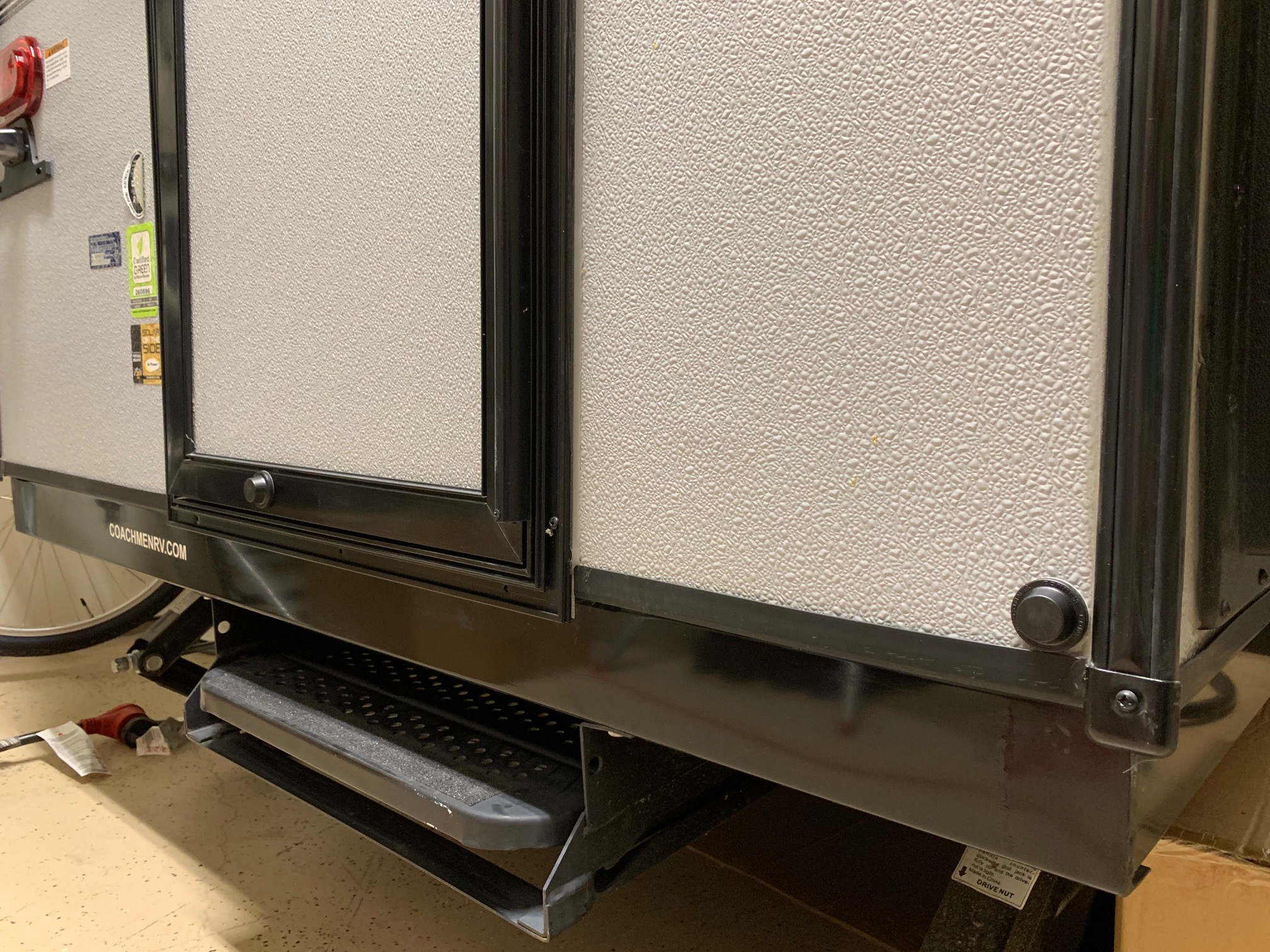

I started by welding a 1/8" plate that I cut to a 2" receiver tube that is 18" long. I also cut, bent and welded what looks like a "chain" strap out of 1" x 0.25" steel and welded it to the receiver tube. The other 2 pieces are angle iron and square tube.
Pic 1 shows the 3 components which are ...
- a 2.5" x 2.5" x 1/4" length of angle iron that bolts to the back side of the Clipper frame (back bumper)
- the 2" receiver tube referred to above
- a 1.5" x 1.5" x 1/8" square tube that bolts to the C-channel that is next closest to the rear bumper.
I'll be adding angle brackets to attach the cross bars to the side rails of the frame. This will further stiffen things up.
Pics 2 & 3 show everything bolted in place. The 2 side by side bolts on the bottom of the receiver tube are anti-rattle bolts for the kayak rack T-bar. Note also that I've started to hide all of the wiring in corrugated loom. As you know, the wiring is a bit of a mess on these things … and many other trailers when they come from the factory.
Pic 4 shows the rear "bumper". The angle iron is attached with 1/2" eye bolts. I've since added a bolt in the centre. I use the eye bolts to latch down the kayaks. The "chain" strap is simply to bolt the rear of the receiver tube to the angle iron. There's obviously no need for safety chains on the rear of a trailer. It does provide another latch point though.
You'll be happy to know that I can still bolt the original rear step assembly to the rear bumper without modifying it. I took it off though to save a bit of weight. We just use a small folding plastic step that I picked up at Walmart.
