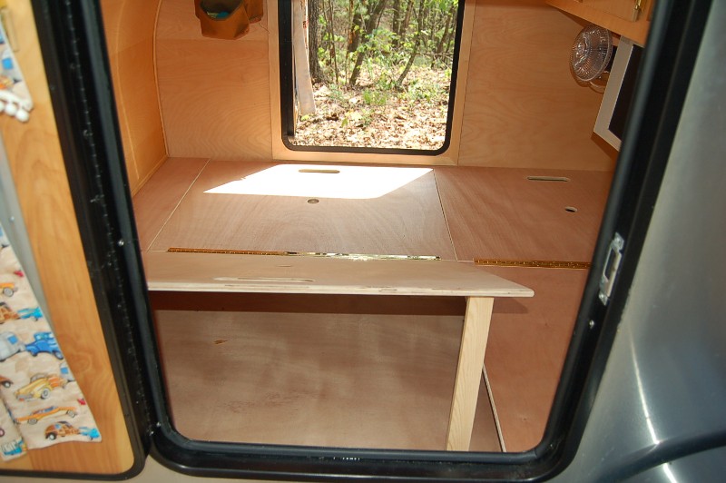

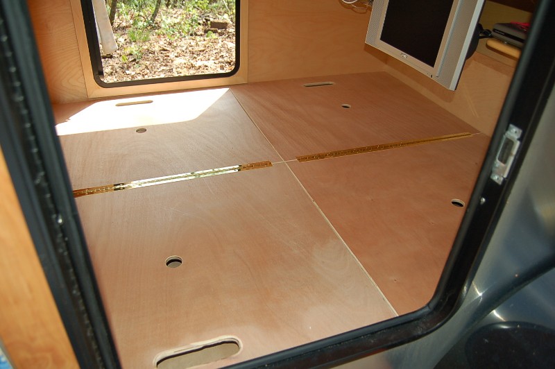

On that subject, here's what I did to make that space a little more useable - especially for my wfe.
The problem was that the hole to lift the boards was in the middle of the storage space, so one had to reach halfway under the mattress to get to the handhold, then slide the board slightly toward the other side, as it extended under the lip of the door. (Clear so far? lol) I ripped about 3/4" off one long edge of each board and added a 1X4 to each side under the door. Now you merely have to slide your hand under the mattress a little bit, lift by the new handhole, and prop it up with a stick. Dixie Flyer, don't go pokin' anything with that stick, now! Anyway, added the piano hinges so one side lifts at a time. Now we have useable space under the whole bed. Yay!
On second thought, just look at the pics. :lol:

It looks like the perfect solution...I kept trying to figure out from the various pics I've seen of them how on earth that space could be accessible. The pics say it all...thanks very much for the idea, Marvin. It looks like it's stable enough that you didn't find any need to brace the center underneath where the covers are hinged together?

Go for the 5X8! You will without a doubt be glad you did. The extra foot translates into 7 square feet in the cabin, or almost 25 cubic feet, and an extra cabinet. The galley is commensurately larger, as well.
As for the middle where the covers are hinged together, there are two pieces of plywood turned vertical under that point which provide support for the area immediately under the hinge. With three points of contact, the bed is very stable - no discernible flex.
