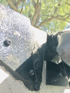

Thank you everyone for your input! It has been extremely educational. I have run into an issue that some may have run into themselves.
One morning on our last trip, it rained quite heavily. My wife and I figured it was no big deal and we’d just hang out in our Clipper until the rain slowed down. Suddenly, we noticed there was a lot of water on the counter on the fridge side. All of the windows were closed so that wasn’t it. I noticed there was a drip coming from the metal trim on the top of the wall. I followed the water up to the hinge and that’s when I noticed the small gap allowing the water to drip in. Pushing the fabric wall up to close the gap. When I checked from the outside, I noticed the rubber “gutter” piece was missing on that side. This seems like an easy fix but I want to be sure I get the right materials. What kind of rubber and adhesive is recommended?
