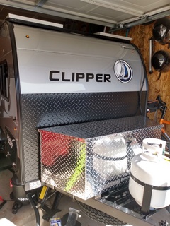

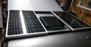

Made a couple of more mods to the trailer. Added a nice large tongue box to the front, and then finished the solar panel install. For the solar panels I used the original roof rack, but cut it down flat so the camper will fit into my garage. I then mounted 2, 75 watt, 12 volt solar panel to each side. They do charge the battery, but haven't had a chance to see if they will keep it charge with the refrig running. I place the battery and the solar controller in the tongue box, but still have lots of room.
Tongue box
Tongue box 1_cr.jpg (60.49 KiB) Viewed 13014 times
Solar panels on roof.
Solar 2_cr.jpg (38.34 KiB) Viewed 13014 times
