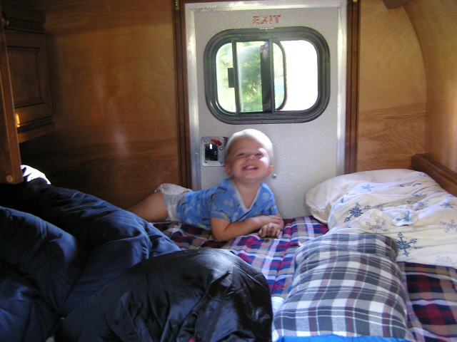

14. The interior is huge. The three of us were able to sleep comfortably. Our little guy even got perpendicular and it wasn't too much of a problem. We sleeped on a king size mattress when tenting and the Mobi was better.

Good review! Now I have to go look for an interior photo! :o
edit: good interior shot too! Image
