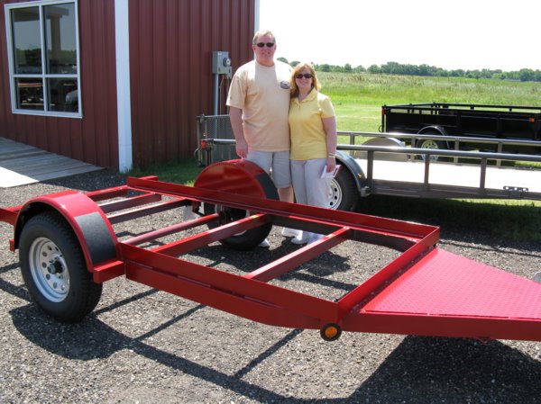

Postby bobhenry » Sun Mar 08, 2009 9:23 am
I snagged this off of a post here on the forum for future use. We have a metal fabrication shop right downtown in our fair city , town naw maybe hamlet of 1800 folks. I would very much like to duplicate this frame for a build. Many thanks to whomever I stole it from , it will be a picture model for the welding shops use.
Aluminum Trailer Frame Kits

We also offer a frame in the kit form that can be shipped assembled or unassembled depending on what the customer wants. These frames are doubled welded 2" x 3" aluminum tube frames and come in a variety of sizes and options.
Check them out at: www.mega-minis.webs.com under the DIY-Kits section.
