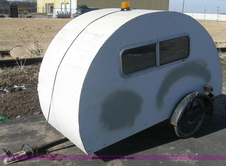

OOPS , just found another teardrop bicycle trailer I haven't seen here .http://www.purplewave.com/cgi-bin/mnlis ... 80207/4148 :thinking:
A plywood bicycle teardrop .
another bicycle teardrop .

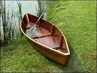

:thinking: I was just getting something out of my garage and saw an old boat I had hanging from the rafters and got thinking that a section of it would make a trailer if I put a top over it and wheels under it .
It looks much like this .
When I get a chance I will take it down and snap a picture . Now don't think I'm cutting up a lovely old antique this is a boat I built a few years ago on the cheap out of luan flooring . " it works " The thing is just before I got around to painting it I was given a very nice aluminum canoe by my father that I use . So this has been taking up space since then . Now I have an excuse to get in down and try re-proposing it . Give it a new life as something other then a place to throw tents and sleeping bags .

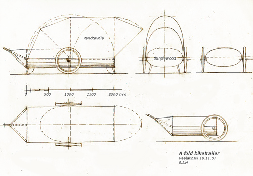

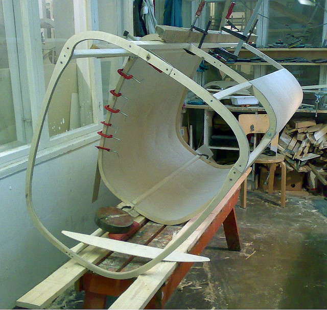

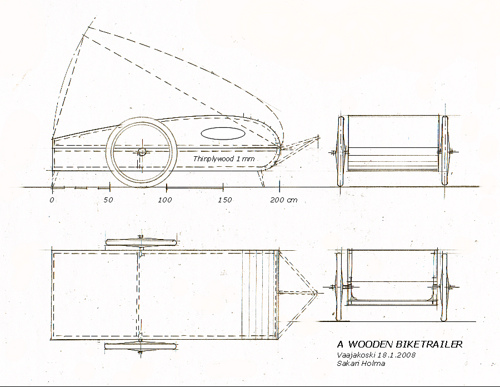

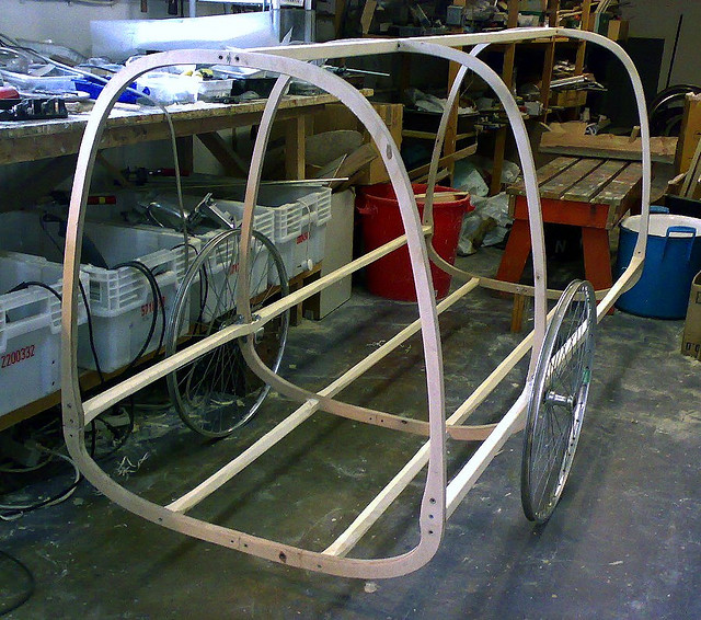

I know these look huge , but Sakuholma's camper really isn't that large . It is far bigger then a tent , the bicycle campers standby but ...anyway here are more pictures of his designs .
print design .
Frame work underconstruction .
More construction details .
As you can see it doesn't use stress skin construction or a box beam design . It's a unibody design .
Live the adventure , embrace the confusion . " Ray "

Postby mezmo » Sun Mar 10, 2013 9:49 pm
Good to see you are aware of Sakuholma's designs and
builds. I had remembered them, but couldn't recall his
name, just recalled it being Finnish. Most of my bookmarks
died along with our old laptop's motherboard, so I was
starting over from zero on most of them. The bookmarks
for him were among those that were lost.
I wonder what the weight on that monocoque of thin plywood
and ribs was ?

Postby razzer » Sun Mar 10, 2013 10:59 pm
He says 45 lbs " 20 kilos " . Here he is on Flickr http://www.flickr.com/photos/saholm/ I believe he's an engineer when he's not building cool bike stuff .

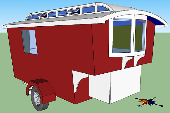

I need some help , ideas . I have some of those blue plastic barrels made from (HDPE) High Density polyethylene Plastic . I was thinking they would make a good roof for a vardo style bicycle trailer . A friend was kind enough to give me them free . Now the problem they are about 36" long/high and I would need to fasten them end to end and then put a cover on them so they don't look like ugly blue barrels . While these barrels a tough the problem is HDPE is used to store all kinds of stuff from those milk jugs in the fridge to nasty chemicals ... including ... thats right glue . :DOH2: That includes our favorites like TitebondII & III and even Gorilla Glue . So anyone have ideas ? I was going to put down an idea I had but I want to hear your ideas first . I would like anyone's thoughts that includes any other newbies too .

Vardo contradicts the aero design requirement. Light weight and aero seem to be predominant requirements for bicycle trailers.
Just because a thing is cheap and available does not make it a good choice. Turn them into keg coolers and invite your friends over to help with your build.
Now if you were to happen onto a couple of fiber drums and wanted to build a bike size version of the Foamstream, I'd say, "go for it".
$.02
