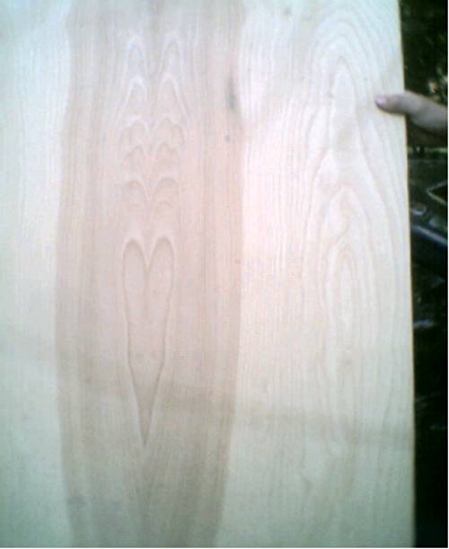

Postby Miriam C. » Wed Oct 04, 2006 5:15 pm
This is Sean's bicycle "bed roll" profile and the veneer he has choosen to make if of. He spent the afternoon separating a door to get these pieces, then cleaning the glue off. :phew:
:peace: Thanks for the help. Sean

Nice figure on that wood! It should make for a really nice bedroll! :thumbsup: Let Sean know we are all looking forward to more pics of the project as it progresses. ;)

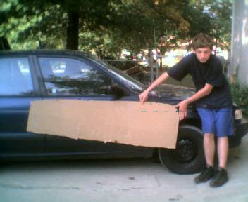

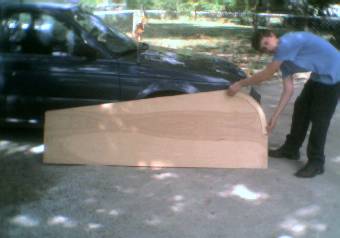

Postby Miriam C. » Thu Oct 05, 2006 2:48 pm
Gregg good idea. I didn't open up in time to get rid of the curve. Sean has a 14 inch radius on the front. He made it bigger than original. It is now 27" tall in front and 20 in the rear. That way if it rains real hard from the sides he can lower it. (living in SW Kansas will teach you that.) He figures on clamping it together and getting an idea of the weight. If the weight is too high he will chop it.
He has an old tent he got for free to get material and windows from.
Here is his cut out sides.
MJ- looked up Econolite (similar to Alumalite) but .016 not .040. might be good for bikes. Asked for a price for each. 8) Thanks
Thanks Amy. He is excited that people got in to give him answers so fast. Already has an idea for a second when he gets his driving licence. I have created a monster. Not sure him mom is please with me. :lol: 8)
