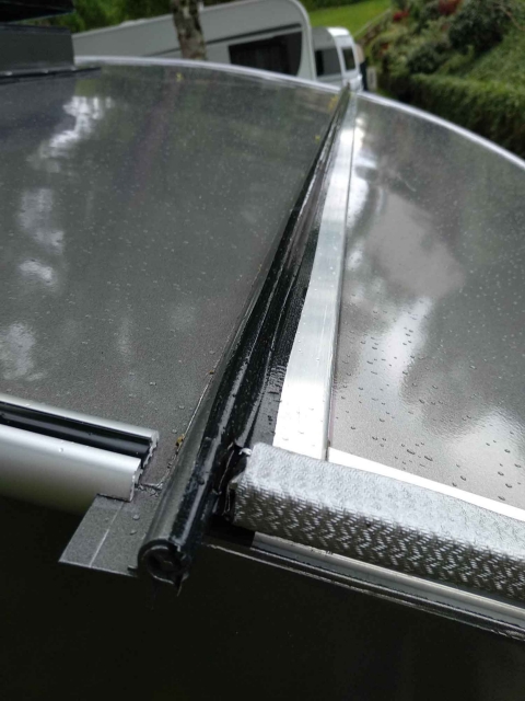

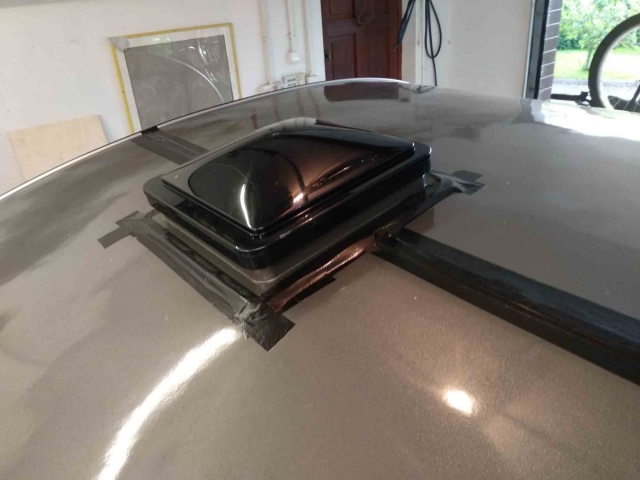

1. I should have tested for leaks. I had big trouble with Fantastic Fan sealing and Hurricane Hinge leaks. I should have tested ofr leaks before I left and tested again just to be sure! Here is my sad running repairs with gaffer tape (that worked OK) that I have to sort out now that I'm home (any suggestions for fixing are welcome):

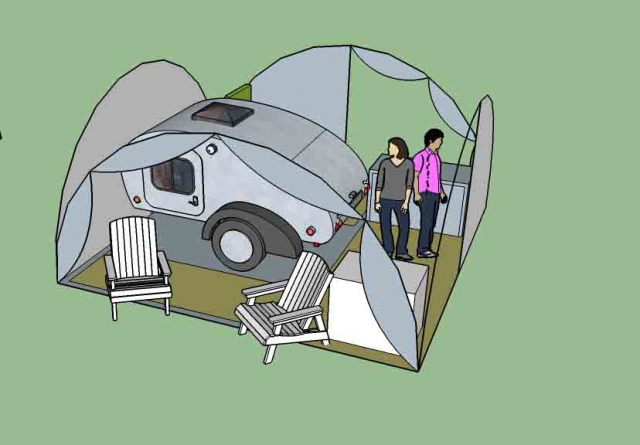

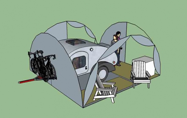

3. I should have thought more about privacy. One disadvantage of a teardrop I found is that when you open the door in the morning you are “on display”. This is not such a big problem if you are boondocking, but we stay in campsites and it is an issue. For my next trip, I plan to buy a 15’ Coleman Event tent with three doors and a solid canvas wall and basically park the thing inside of it.
This will have the added benefit of keeping everything drier in the Irish summer rain (see point 1). Here is a sketch-up of what I envisage:
Someone once said that the first thing you do with a Fantastic fan is to throw away the seal that comes with it. I use butyl tape and then caulk the edges with a clear polyurethane sealant. No leaks since I installed it in 2013.
The only time my hurricane hinge leaks is when it is nearly level. Water flowing to the rear hits the hinge and starts to run off the overhang --but the surface tension causes it to run under the hinge and inside.
I solved this by gluing an inch of bead-chain to the edge to guide the water off. I think it works.

156749 If you have a leak-it needs to fixed!! -but something I use, is a Max-Air cover over the top of the air vent, at first, I didn't care much for the look but after awhile I got used to it and when it comes to 'function', function out ways looks - having this cover on works great!! even when it's raining out, I can have my vent open and it is very easy to remove for cleaning. just :thinking: (also even if I forget to close it - no rain gets in) something to think about...............

I like that Coleman tent, not sure if it would work for us. Can't wait to see how it works for you.

We have a strip of rubber roof over the galley hatch hinge.

I went with tarps attache to Kedar rail on the tear.
