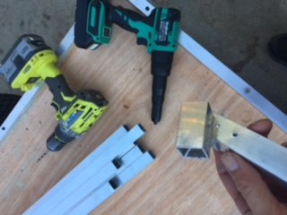

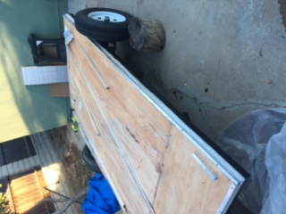

I attached some photos of my 6' x 9' steel trailer chassis build, which has plywood flooring.

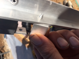

I originally started riveting the aluminum frame with rivets I found on amazon, only
to realize the amazon rivets are the wrong size, so the corner bracket is loose.

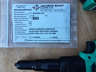

I just purchased rivets from Hanson supply, they arrived in the mail today, and I will proceed to use Hanson rivets only!
I have a rivet grip range, and will purchase aluminum square tubing, and cut the squares as you suggested.
I will make sure the aluminum cleats, and frame thickness matches the rivet grip range.
Thanks for the tip on making angled cleats!
(The cleats are made from 1x1x1/8 angle using a drill press w/fence & cut to one inch length with a horizontal band saw.)
Hanson supply Rivet dimensions:
blind aluminum rivet closed end with steel mandrel
rivet size: 3/16 "
rivet grip: .313 - .375

loose rivet
My new hanson rivets

I applied rivet PASD606H to aluminum cleats, with good results!
The framing has a solid grip, but I am still able to move it slightly with my hand.
Does a well placed rivet allow for some slight movement by hand?
attached are photos for reference:
Aluminum frame is movable by hand
But it does not move easily, I really had to push it

Sounds like you're OK. Make sure to use the correct drill bit & make sure the rivet head is seated before pulling the trigger. Sometimes the rivet needs to be tapped down into place.

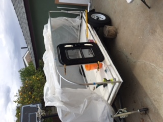

I have been building my first aluminum TD, I just want to say thanks again for your help!!
(I am having trouble finding suppliers for 6 foot wide aluminum skin, so I will just glue and rivet 4 foot skin pieces.)
Attached is a image of my framing work so far...
