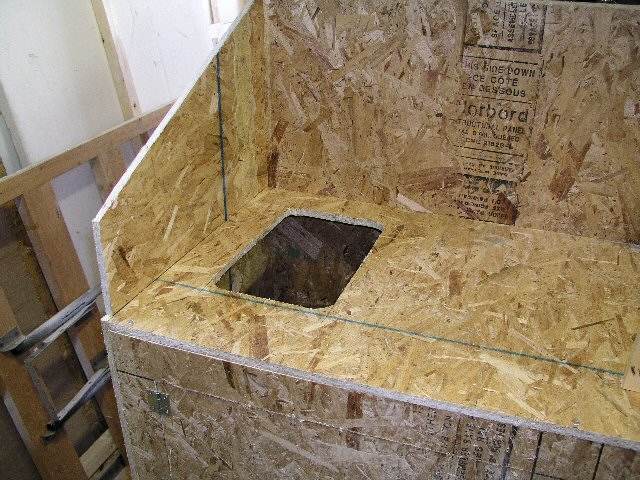

This morning I cut a hole in the counter top...

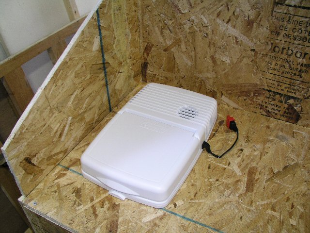

Then I dropped in a thermoelectric cooler unit
Then I figure I'll make the doors on the front look like an antique icebox
I don't know how many amps this draws yet, but I'll hook it up later today, and let you guys know what I find out.
Postby campadk » Sun Aug 01, 2004 9:34 am
Mmmmmmm... current!
My Koolatron draws 3.1A... which is why is has since been dumped in the 'garage sale' bin. Mike you'll have to add some more holes for a few extra batteries!! :wink:

Postby mikeschn » Sun Aug 01, 2004 9:45 am
campadk wrote:Mmmmmmm... current!
Oh I know, that's my biggest concern... It would be nice to have 12v cooler that would last for a weekend, camping rustic. But the icebox could always use ice... I recall Sumner using both ice and 12v thermoelectric at the same time... Hmmmmmmmm...

Okay I just checked... it draws about 2.6 or 2.7 amps, or 64.8 amps every 24 hours.
To replace 65 amps a day with a solar panel I would need at least the 120 watt panel shown here... and 9 hours a day of charging time.
Not a real pretty situation. So going rustic really means ice. The only other option I can see is charging the battery with the tow vehicle every day.

Postby campadk » Sun Aug 01, 2004 5:25 pm
My theory.... teardrop = KISS.
After debating this one for a good 6 months, we went with a cooler in the tow vehicle. Why not just buy a retro cooler? Or the Coleman stainless steel coolers which should blend into the theme.
Even a custom built in cooler, well insulated using just ice sounds like the plan. Since those 12V units only cool so many degrees below ambient temp, you many find the 12V unit actually melts any ice you have in the box :shock:
