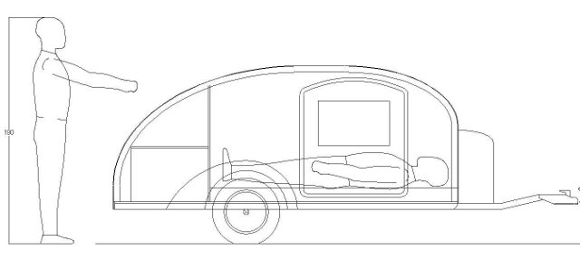

Hi all,
I thought I'd share my design with you: I have a pretty good idea now of the profile of the TD I'm planning to build.
Took what I thought to be the most practical points of several designs, mainly shape-wise:

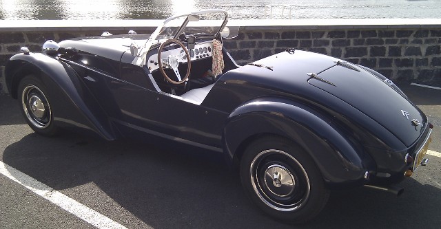

The combo, with the Burton up front, will look like this:
Note that the cabinet section is not complete yet. Still looking for more inspiration :)
Weight will be a major issue. The TD will be 290 cm (9' 6") long, and 122 cm (4') wide. Ready-to-roll weight should not exceed 400 kg (880 lbs) (loaded! :frightened: )
The walls and floor will be 12 mm (1/2"), floor only insulated by mattress, walls will have 10 mm (3/8") EPP on the inside, finished with upholstery material, probably vinyl. No framework on the walls, I expect the cabinet section to provide some strength. Roof will be 3 mm (1/8") outside and inside, insulated. At this point I'm still undecided: what height of the spars is mostly used? Is 38 mm (1 1/2") acceptable? How about less than that?
The doors will also be 12 mm (1/2"), they will be some 3 cm (1 1/4") larger than the door-opening. They will sit on the outside. This should eliminate the need for aluminium trim, but I should still be able to create a good weather seal between door and body. As the door will be relatively thin, I won't use ready made windows, but I'll make something myself. Windows should be able to open and have insect screens.
No alu cladding, I plan tu use CPES or whatever equivalent I can find over here in Holland, then followed by a good quality epoxy yacht paint.
Chassis will be a simple rectangle of 5 cm (2") angle iron, New Lightweight Cub style.
I expect to be able to start construction around October...
Any comments would be welcome!
Willem

Looks like a nice lowrider Benroy. What the height of the sides?
You might want to skip on the standard forward cabinets. You will hit your head trying to sit up.

Postby DMcCam » Thu Aug 16, 2012 10:31 pm
Hi Willem, Good looking design sir. Junkboy's right, the forward over head cabinets would be head bangers. You could add a simple aft cabinet over your feet though. A single shelf from side to side and a simple face frame with cubbies or doors shouldn't add much weight. You'd get a ton of useful storage. I built all my cabinets and shelves with 1/2" Baltic birch cabinet grade plywood. They are very strong without too much weight.

Postby WillemII » Tue Aug 21, 2012 3:42 am
Junkboy and Dave, thanks for the suggestions. To be honest, I too have my doubts of the interior height. The side walls would be 4ft high, but, as a friend here in Holland also suggested, one wouldn't even be able to sit up. But is 4ft not the 'standard' outside height most TD builders use?
I did find out though that I can obtain sheets of 130 cm width (just over 51") so I'll probably go for that, both for height and width.
Junkboy, the car, I'm afraid, is not an Alfa, but a Citroen based kit car. It is called a Burton. The factory is in Holland. The Burton is based on a Citroen 2CV.
The car is only 900 lbs, engine is 2 cylinder, air-cooled, 30 hp, so keeping the weight of the TD is a crucial factor!

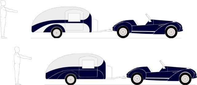

Postby WillemII » Fri Mar 01, 2013 5:18 am
Bikerman, I've been playing with the colours...

Postby DMcCam » Mon Mar 11, 2013 10:46 pm
Hi Willem, I like the bottom one, it's a stronger design. :D
