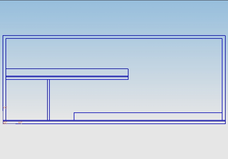

If it were me, I would build a 5x10 teardrop in this configuration. The queen sized bed is on the floor with the pillows toward the front of the trailer.
The kid's bed is about 18" higher than your bed. Your feet go under their bed.
They can sleep 3 across. Their bed is shown about 66" long but you could make that anything you like.
Once the kids are out of the teardrop, you can convert the bed into a galley. You could plan ahead and hinge the part of the bed that is in the galley, and have it hinge up and out of the way to use the galley.
It's rough, but this is kinda what I am thinking about.

Postby Alfred » Sat Nov 03, 2007 8:59 pm
Hi Mike,
I am wondering if there would be a way to combine the extra bunk and keep a modified galley, with a hinge or slide in/out or something, so that the galley space could be used as a galley space, then converted into bunk space in the evening? Maybe like hinge the bunk in the middle, so that 1/2 bunk would fold down over the Galley counter.
I am thinking we would lose the upper cabinets in the galley, and in the cabin, where the bed would swing in place, but the galley counter top and bottom cabinets would be intact. Then when the kids move out, I could retrofit the upper cabinets back in.
I think your plan is moving in the right direction with the dilemma.

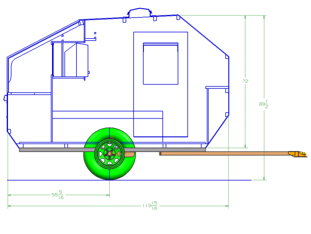

Postby mikeschn » Sun Nov 04, 2007 6:47 pm
On my HF chassis, the body starts at about 19" from the ground. So unless you are willing to get a torsion axle, you will be limited to about 48".
My Lil Diner had a torsion axle, and was 52", but it would have fit in your 68" of clearance.

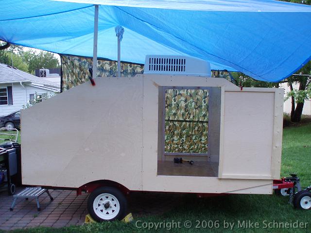

Postby mikeschn » Sun Nov 04, 2007 7:45 pm
You only need protection while you are building.
We built the Escape Hatch under a tarp.
