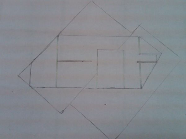

Postby SpringerNC » Tue Oct 06, 2009 1:55 pm
Really want a teardrop, but have 3 kids, so REALLY need to build for more than 2, want to stay on the 4x8 scale, or build a 5x8 on a 4x8 trailer. So here is my idea. any feedback/conversation is appreciated. shown in the drawing is the galley, a bunk bed, and storage up front.
The reason I drew it like this was a seam question, I was trying to only have one seam, and figured a diagonal seam would be better that vertical? thoughts......

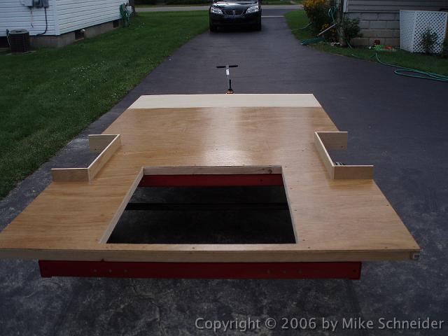

Postby mikeschn » Tue Oct 06, 2009 5:35 pm
Here's our 4x8 HF trailer, with a 66" floor.

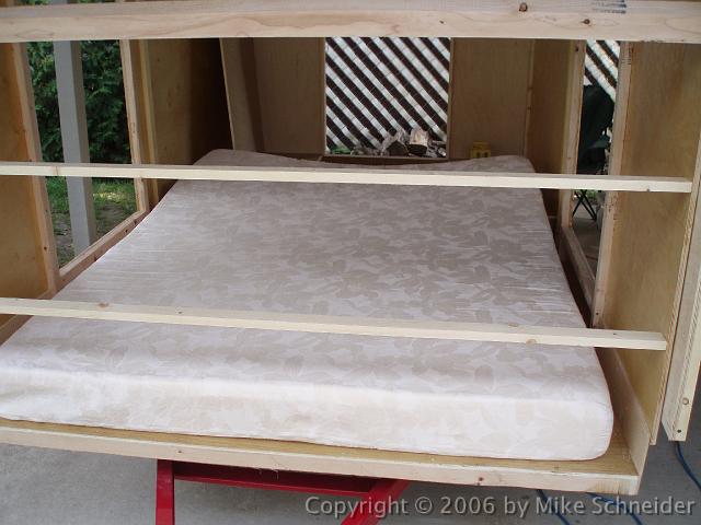

and here is a queen sized mattress in it...

yup, I have to do that, I need an whole family inside camper, so tents can be a secondary....66 wide it is, now for the rest of the measurements!!!

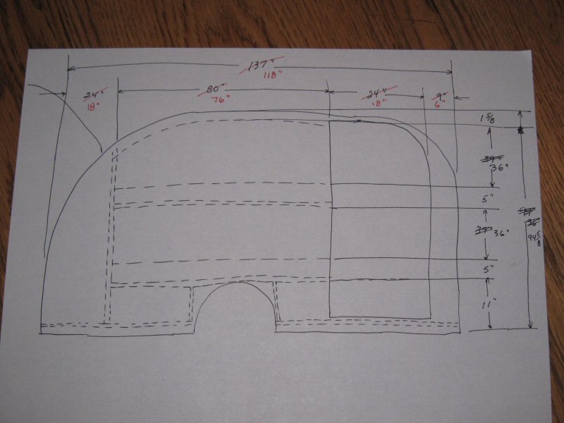

How much room do you figure you need between the lower bunk and the upper bunk? I'm thinking 39".
Postby SpringerNC » Tue Oct 06, 2009 5:54 pm
just laid down on the floor with a tape measure, as I do for most of my figuring, and 39 seems a long ways away...

Postby SpringerNC » Tue Oct 06, 2009 6:00 pm
but I guess if we are talking 2 queens, that is a good distance....hard to visualize

1x2's on your flooring for 66 inches wide?

Postby mikeschn » Tue Oct 06, 2009 6:13 pm
Just for fun, I quickly scribbled up a design for 5 people... with a galley, since that seemed important to you in your first post.
then of course, the size was unreasonable... so I started shrinking the numbers.
I finally got it down to 10' long and 8' high. I'm not sure those numbers are very appealing. The 8' high seems too high.
But I'll post it here so you have a starting point.

On that subfloor I used 2x2's.

Postby SpringerNC » Tue Oct 06, 2009 6:38 pm
wow thanks, did not think about having to be raised to clear the wheel wells, I think I will ditch the galley for a tear drop build one day, and gain the space for a bunk for the kids.
