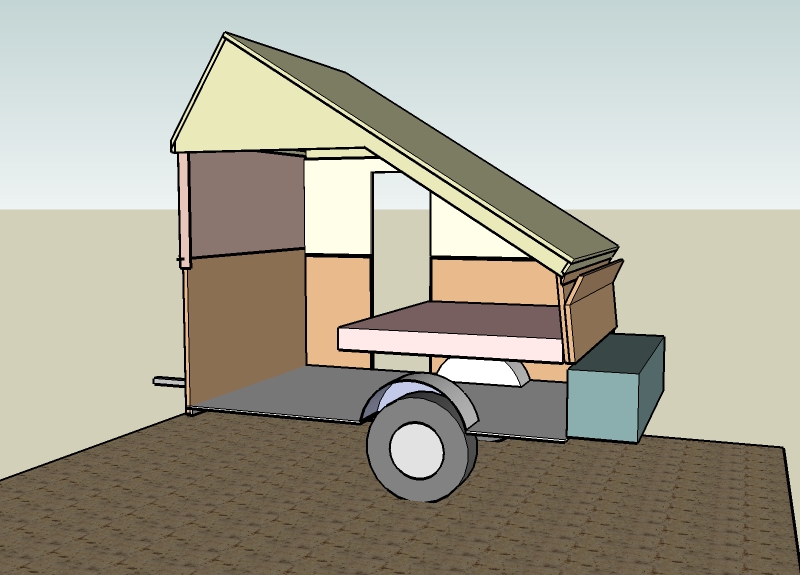

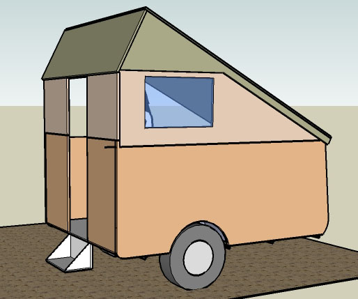

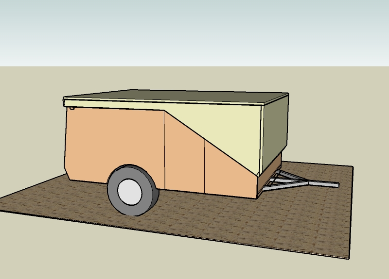

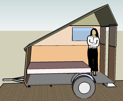

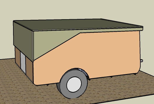

The body sidewalls are 4' high. Interior height at apex is 7.5'. This version has a 9' long body. I also have a 12' body drawn, but prefer the shorter one for off-road-ability. The added interior length is very tempting, though...
RAYVILLIAN wrote:The only problem I see with your design is holding the top up while pulling the rear wall up. A top that size would be quite heavy and I'm not visualizing any way to add a lift assist system to it.
Other than that it looks great.
Gary
