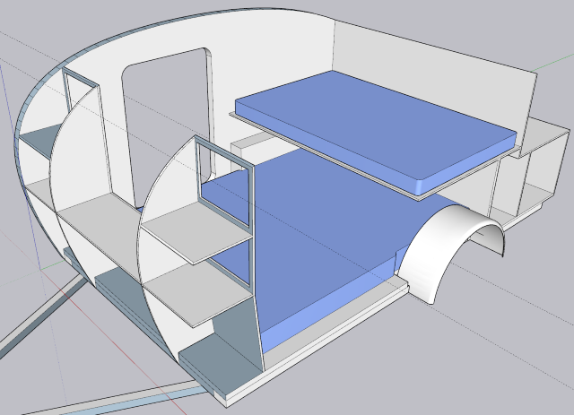

I'm getting closer to starting construction and have my design hopefully almost done. The two big things left are the layout of the galley (which is pretty well fleshed out in my mind if not in Sketchup) and the placement of the A/C and ventilation which has me totally stumped. I'm hoping some of you might have better ideas than I do because all I can come up with is going to be some combination of expensive and time consuming.
First, let me introduce you to my design:
It's a mashup of the Atma Travelear profile with the innards of the 2+2H from the design library. There's two mattresses so the kids can come along, cabinets in the front of the cabin and doors on each side. These features should ensure we can bring everyone and everything we want but it also has the effect of basically using up all the wall space in the cabin. I'd like (and my wife requires) a small air conditioner like a $200 window unit.
Ideally, it would work so that all occupants would receive some of the cool air without it being right by someone's head or feet, chilling them just so everyone else can feel some of it. I also want it permanently installed, not having to hook it up and remove it at every campsite. It has to be accessible without tearing the camper apart so that I can clean and eventually replace it. I'm optimistic the teardrop will outlive the A/C so access is critical, even if there are several bolts involved. Finally, I'm trying to keep the costs in check.

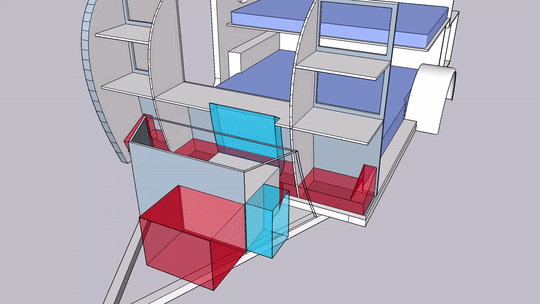

I'm actually thinking about that kind of vent arrangement with the tongue box approach. See image below.

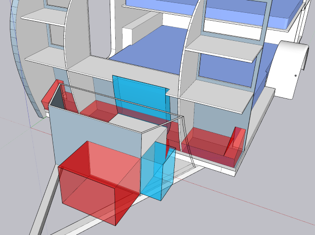

You and I are on the same page. After exploring the tongue box option further, this is what I've come up with:
I made the image animated (hope that shows up for y'all) so that it's hopefully easier to see how it all overlaps. And also because I've never done that before and I was curious if I could. :)
The red ducting is hot air movement: from the cabin to the front of the unit and also exhausting hot air out the back of it. Blue is cold air blown into the cabin or drawn in from the outside to feed the exhaust.
The obvious downside is I'm giving up a good bit of storage space for ducting, about 3 cubic feet overall. The upside is it would be integrated into the tear and *should* provide good air distribution. Anywhere else I can think to put the A/C unit would be entirely inside the cabin so also taking up space, probably about that same 3 cubic feet. That'd be either with the A/C unit in the front cabinets with no ducting or at the foot of the lower bed but with ducting (so probably even more space consumed).
I'm really appreciating y'all's feedback. Keep it coming!

In my teardrop, with the ClimateRight predecessor, I had a return air grill at the foot of the bed and ducted it underneath the teardrop to the unit in the tongue box. This allowed for a flow-through ventilation.
Regardless of your method, be sure that the return air duct is high enough to be above mattress, pillows, heads on pillows, and/or feet if ducting from the back.

aggie79 wrote:In my teardrop, with the ClimateRight predecessor, I had a return air grill at the foot of the bed and ducted it underneath the teardrop to the unit in the tongue box. This allowed for a flow-through ventilation.
I've looked at your original setup as a starting point for all this. I didn't realize you had the return air running under the cabin. How did you ensure it wouldn't get damaged on the road?
aggie79 wrote:Regardless of your method, be sure that the return air duct is high enough to be above mattress, pillows, heads on pillows, and/or feet if ducting from the back.
The current design has return air grills on each side of the mattress. Because of the perpendicular upper bed, there's about 4 inches on each side of the lower mattress.

I like your work, nice job. I think you're making it harder/more complicated than it has to be. I would try really hard to get the whole control side and the evap into the headboard and get rid of all the cold side ducting. just the compressor/condenser hangs out in the utility box. You just need a few vent doors to let air into the box, to minimize/eliminate the ducting in the box I would just add a 6" muffin fan to continually bring in cooler outside air.
I'm sure your design will work too. It just seems like more work and possibly experimentation to get it right.
