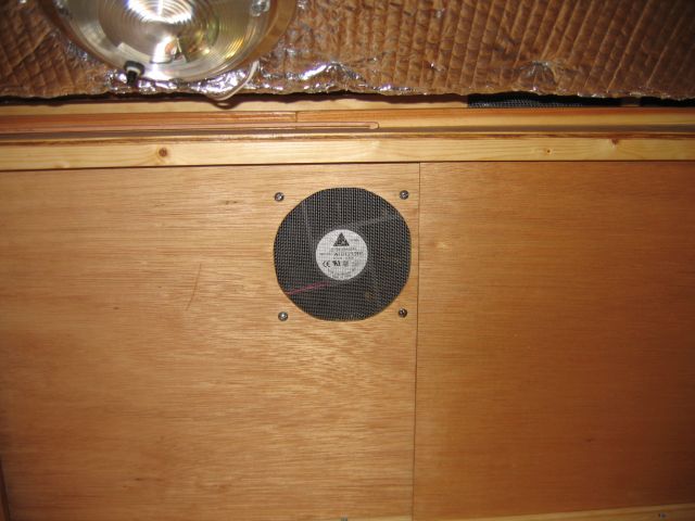

Installed 5 inch 12 volt computer fan for ventilation.

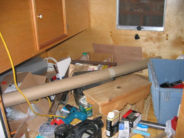

Loaded with tools ready to haul home from the tear drop shop.

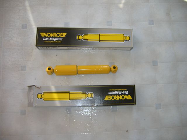

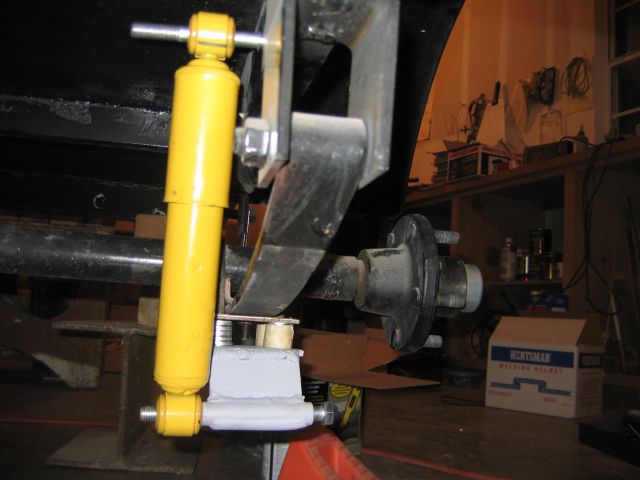

Well today windsong has started getting shocks installed on it. They are Monroe 555002 shocks, and RB514 mount kit. The RB514 bracket had to be modified by cutting of the lower flange and lowered it 1 and 1/2 inch by welding in a peice of metal. Thanks to my Father in Law for doing the welding. It is well on it's way to being shock equipped.

Monroe #555002 Shocks
Side view
Inside frame looking to rear.

Postby bledsoe3 » Sun Mar 04, 2007 3:53 am
I think the shocks are a good idea. But, if it were me, I would put gussets on those mounts for strength. I tend to over build though.

Postby madjack » Sun Mar 04, 2007 3:59 am
JP, I would also highly recommend a gusset of some type...otherwise there will be a lotta pressure on the weld...even if just one in the center of each mount.......

Postby jplock » Sun Mar 04, 2007 8:21 am
Hey Guys,
Thanks for the advice on the gussets. It sounds like a good idea to me too. Again Thanks!

Postby WarPony » Sun Mar 04, 2007 4:34 pm
Phil, I see the bumpstop on the frame. Do you know if you've ever bottomed out enough to use that? Will you take them off now that the shocks have been added?
I'm REALLY considering adding shocks now that I've seen your setup. Your springs and axle (axle on top) look just like my Jim Dandy suspension.

Postby jplock » Sun Mar 04, 2007 4:52 pm
Warpony,
I will leave on the bumpstops, and I don't recall ever hearing or noticed that it has bottomed oout hitting the bump stop. I will ocasionally get on a rough back road somewhere and I do have a SUV to tow it with and there is approxamately 14'' of ground clearence on the trailer. I could venture int some places that could almost be considered off roading. That is why I will leave the bumpstops. Oh by the way the bumpstops are what goes Jeep CJ rear axle. I will let you know how they work out. I hope it prevents scrambled eggs in the ice chest when it is riding in the rear. I had a batch of scrambled eggs on the way to the LCG campout last fall.
