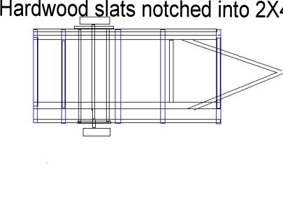

Greg,
Do you have a drawing that you could post to let us see what you have plannned?? If you have a hand drawn one, just take a pic and post that.

Postby Bigwoods » Tue Apr 17, 2007 12:45 am
Kerry,
I am going to use 2X4 siderail 8' long to run the length of the trailer. They are supported very well in the rear by the angle iron above the widened springs. I am going to bolt the 2X4 through the holes that are in the angle iron.
My concern is the front of the 2X4s, by the tounge. We were going to weld steel supports to hold the front of the siderails, but decided to just notch the siderails, which sit a little higher than the frame, and have several "slats" across the trailer. The slats will be some hardwood I have laying around. Plywood will be across the slats to hold it together and bolted to the frame.
I think this will work as you only have 6" of floor extending past the frame. The frame supports all the weight.
The walls and the siderails will ride inside the angle iron. so the walls will hide the 2X4s. I hope to have some nice fenders to hide the exposed angle iron.
Originally the guy helping me thought we should run 2X4s across the frame for support, but if the base of the walls run parallel to the siderails I would be cutting more height away fron the interior.
I hope this is clear as mud. I will try to do a better drawing of the plans.
Greg in Northern Minnesota

Brainstorm!
Postby Bigwoods » Tue Apr 17, 2007 12:52 am
I just realized that I was worried about the front corner supporting the weight. I could stick a piece of angle iron in the front corner and drill a hole in it the use the existing bolt on the bottom of the rail.
That would support the front of the siderail without welding or drilling any holes in the frame. I think that will work, but I'm tired and maybe not thinking clearly.

Postby toypusher » Tue Apr 17, 2007 3:09 pm
Bigwoods wrote:I just realized that I was worried about the front corner supporting the weight. I could stick a piece of angle iron in the front corner and drill a hole in it the use the existing bolt on the bottom of the rail.
I think that this is the right direction. Are you running the angle all the way across the width of the frame and the extended part. That's how I interpreted what you said and think that would be more than sufficient to support your siderails. All of this will become a single unit when the entire box of the teardrop is put together. I would put some support under all four corners until you get most of it built. I had jackstands under mine until I was ready to pull it out of the garage for the first time. I was 99.99% percent complete before I removed the jackstands.

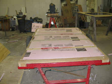

Postby Bigwoods » Mon Apr 23, 2007 11:43 pm
I'm still at it making some progress. The floor is nearly done, with some more trimming to do and more evil black stuff. On, thats nasty..
This is the floor before applying the plywood to make the floor.

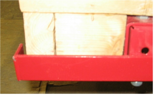

I took the support for the roller wheels that come with a Harbor Freight trailer. A little cutting and some paint and it bolted up just right. The 3/4" gap will carry the side walls.
This is a close up of the support. It should work very nicely. I'll have to figure how to hide it if I decide it is needed.
