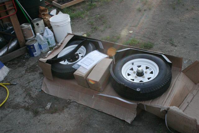

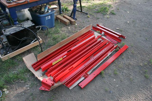

Started the unboxing today at 6:00pm -
Worked on the trailer till 11:30 got it all together with only One trip to Home Depot (Needed some class 8 bolts to replace the tractor pins)
Here are pics of the Unboxing:
Trailer as it has been sitting Since 4/24 :(

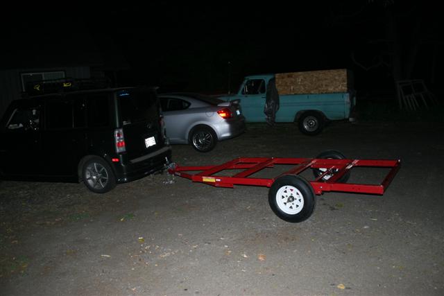

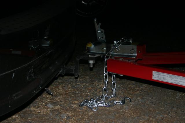

hooked it up to the Scion to see how it will look
WELL we are going downhill :x
When I was assembling the tongue I just knew it was going to be to high.
OK-Options
A. Raise hitch - Already raised 3" - Don't Like the Idea
B. Go to 8" tires - Really Don't Like the idea.
C. flop the hitch mount over to the bottom and use some tube and class 8 bolts to remount the receiver - Best Idea SO far
D. Got any ideas? :thinking:

Postby Miriam C. » Sun May 27, 2007 6:51 am
:o Yep. Go to TSC or U Haul and get a hitch that is intended to raise it. Now get back to work. :D
Postby Tear Les » Sun May 27, 2007 8:26 am
mikefowler wrote:WELL we are going downhill :x
OK-Options
Tomorrow the floor! :twisted:
Kinda depends on how low it is. Judging from the photos it looks like the easiest fix would just be a hi-rise hitch ball like this one from Northern:
Hitch Ball
What is your objection to a taller drawbar (ball hitch mount)? It looks like the top of the ball is still lower than the top of the rear bumper and under the lower edge of the lift hatch (course I can't see it in person).
I use the Rapid Hitch which is an ajustable billet aluminum beauty. It's not really inexpensive but it's got two hitch balls (the one I have has 2" and 2-5/16" but you can get 1-7/8" and 2") and I never have go looking for the right drawbar or ball size.
Les Lampman
Tear Les
Posts: 244
Joined: Thu May 17, 2007 9:52 am
Location: Whidbey Island, WA
Postby Joanne » Sun May 27, 2007 9:45 am
Mike,
I'm with you on option C.
If you can redesign the A frame tongue so a piece of 2x2 (or whatever is the correct size) fits underneath the tongue, then the coupler mounted on that, you would be close to level. Before committing to rebuilding the tongue, I would try removing the coupler and clamping it to the bottom of the tongue with C clamps or vise grips just to see where the trailer would ride. You might be able to "tweek" your design at that point to get it dead level.
Let us know how it turns out.

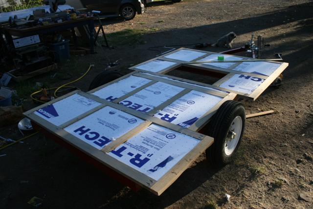

Day two

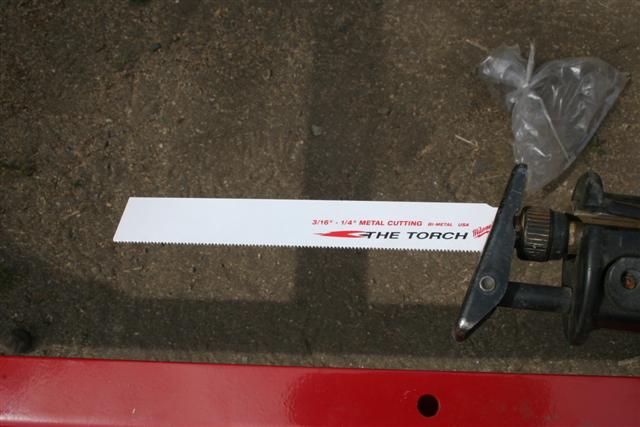

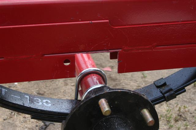

Had to still cut the frame for axle clearance Before cut
After cut
The tool went thru like Butter! 8)

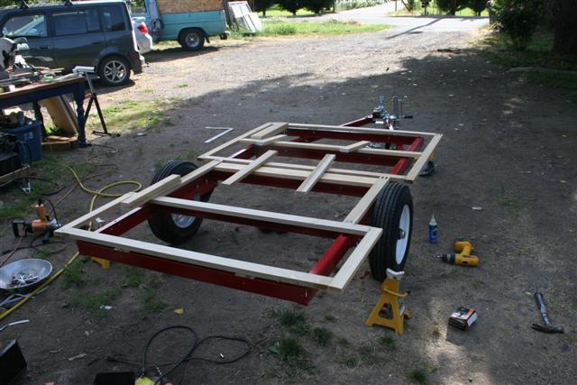

Floor rough in.

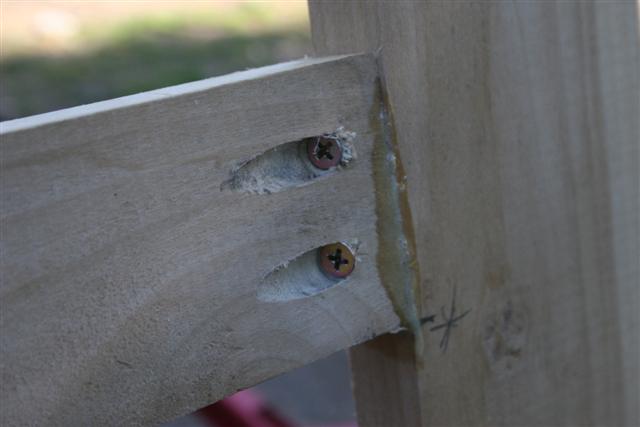

Framing Connections With Pocket Jig
Screwed & Glued :R
Floor with Insulation & floor panel complete

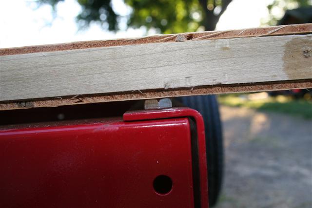

QUESTION? :thinking:
Should I just bolt the floor down or should I drill recesses for the bolt heads so the floor panel is flush with the trailer frame?

Postby Miriam C. » Mon May 28, 2007 6:19 am
Wow! Lookin great Mike. If you can drill recesses I would. You can also put a long shim under the gap. I really don't like gaps. :thinking:
GitRdun :thumbsup:
Postby toypusher » Mon May 28, 2007 9:11 am
If you don't level it to the frame (recess bolts/shim low spots) then your floor will not be level. I ran into a problem with the bottom of my hatch closing and sealing correctly due to the crossmember being about 1/16" smaller than the side members of the HF trailer. To fix it, I put a piece of 1/2"wide x 1/16" thick AL in there as a filler.
toypusher
Posts: 43040
Images: 324
Location: York, PA Area
Postby Esteban » Mon May 28, 2007 4:42 pm
Wouldn't cutting plywood, as thick as the offset in the trailer frame, into long shims be an easy and cheap solution to help level the floor? Counter sink for the bolts. Then use black roofing goo, or your waterproofing of choice, to cover the road side. You're moving along well with your build.
Steve - SLO, CA
Esteban
Posts: 1684
Images: 15
Joined: Fri Jul 28, 2006 4:39 pm
Location: California, San Luis Obispo
Postby bledsoe3 » Mon May 28, 2007 6:45 pm
You could use a forstner bit to make reliefs for the bolt head to set in to. I know you're trying to build light so this would not add any weight to your build.
bledsoe3
Posts: 3694
Images: 112
Location: Oregon, Portland
Postby mikefowler » Tue May 29, 2007 1:36 am
Hey Jim- Great minds must think alike!
8)
Had already drilled the holes With...
That right you guessed it a 3/4 forstner bit!
