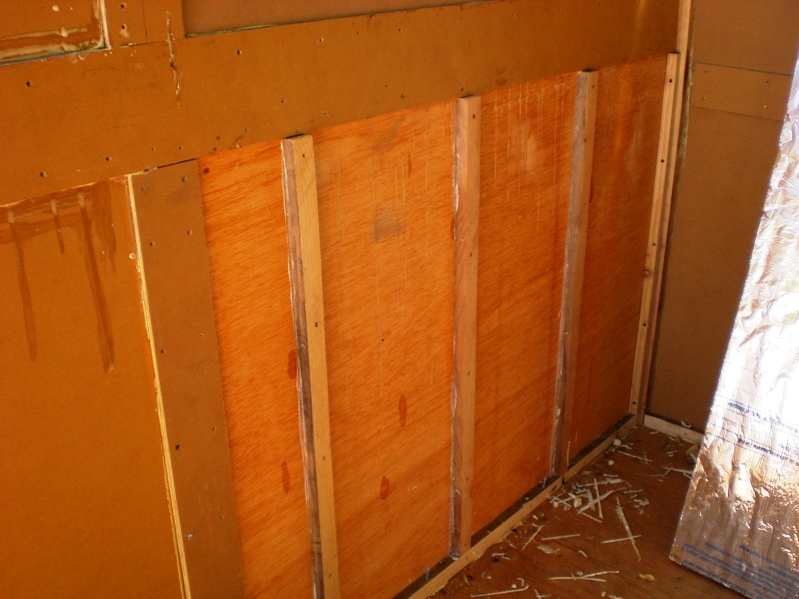

Prem wrote:
Any guesses what that taped line is for?
As the plywood is fairly thick, I'm going to hazard a guess that you are going to (or have made) a partial cut in the plywood there to help it bend around the trailer's planned sort of aerodynamically pointed behind? The glistening stuff is some sort of flexible substance that stabilizes the plywood so that it doesn't break or tear there when you bend it?

Prem wrote:
P.S. Sharon, yup...but what is it that glistens?
I'm going to say some sort of silicone or roofing substance. The only way I'd know for certain is to look at every product at the store and then it would still be a guess. The fact that it looks black in the picture makes me think it is a roofing substance that might be used around flashings and the like.

Postby Prem » Thu Oct 08, 2009 11:59 am
Sharon & Ageless,
Epoxy resin.
History: I grew up in the 60s making surfboards using polyurethane foam, polyester resin and fiberglass cloth. :designing: In the early 90s I built a 26' wooden boat and discovered epoxy resin and all the powders one can add to it to make specific glue strengtheners, sandable putties, fillers, etc. With epoxy: "The sloppier the joint, the stronger the joint".......because hardened epoxy is stronger than wood. Put a little acetone in the mix and it's a laminating glue that penetrates deeper into the wood making a blended wood and epoxy joint. 8)
Trailer floor: I also taped the underside and edges of that dado cut when I folded the rear floor plywood sheet up. That made a dam, so no resin could escape). I dadoed and resined that section of the floor plywood because that was the easiest way to keep from having another butt joint in the floor and a narrow strip of plywood flooring to fasten down separately.

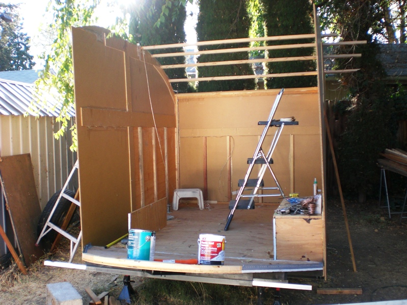

Postby Prem » Thu Oct 08, 2009 5:33 pm
Construction continues:

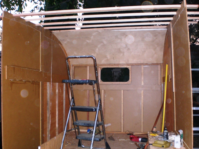

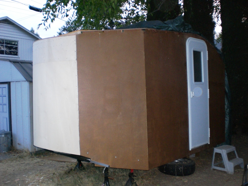

Postby Prem » Fri Oct 09, 2009 10:35 am
:rainy: Racing the coming rains to get it enclosed:

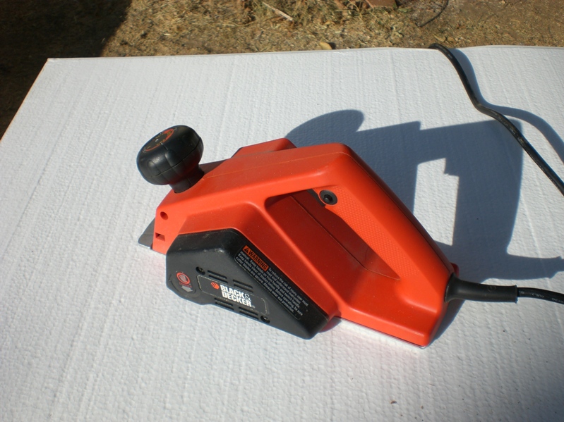

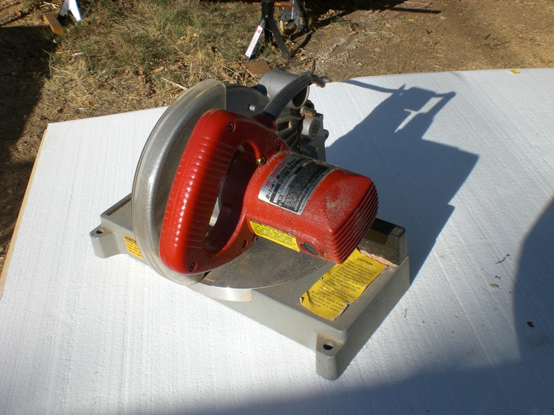

The right tools make the job fast and clean
Flat, tight roof-wall joint thanks to a brand-new $5 Black & Decker planer I found at a yard sale.

Favorite tool. (Small, nimble and a lowrider!)
A Makita antique. Brand new from a 91-year old fellow having a garage sale.

Postby S. Heisley » Sat Oct 10, 2009 9:58 am

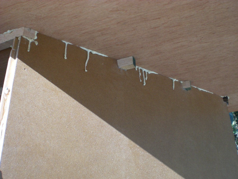

oOOOo! I want one of those! I'm rotten with a hand planer. What is that white stuff that you used to glue the roof down with?

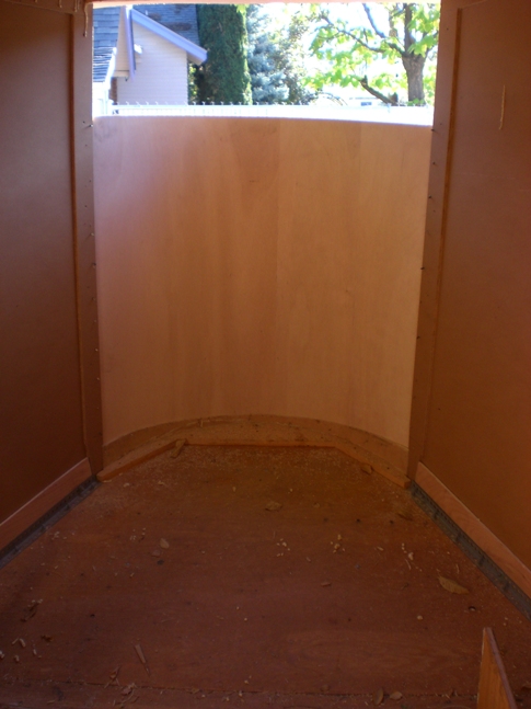

Um, don't take this the wrong way; but, your rear looks real nice. I can't wait to see this new teardrop creation!

Hand plane? Oh no. :shock: That's just slow w-o-r-k! With an electric planer you just have to steer...and be very careful how much it is taking off. A sixteenth of an inch is usually plenty per pass!

It's polyurethane glue (aka Gorilla Glue, but I buy off-brand and get a lot more for the $). It foams up if nothing is compressing it. Others say it is not gap-filling. That's true if you allow it to foam up, but if you wipe it with a putty knife right after it foams up, it returns to paste and fills gaps with lasting strength. It bleeds out of tight joints like those shown. The dried excess (foam) just comes off cleanly with a sharp putty knife (not razor knife).

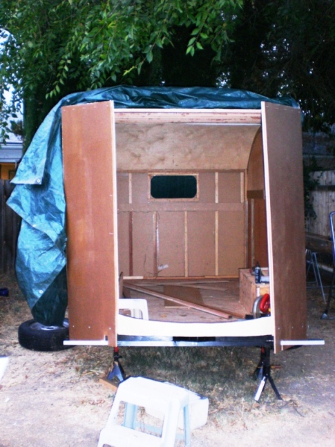

Postby Prem » Mon Oct 12, 2009 1:07 am
Alan,
This is my RV build #9, and it's definitely the most interesting of them all for me. On this project I've had to make up some new-to-me construction methods (today on the tail cone). It's also the first time I've used bending plywood---two laminates with the grain in the same direction laminated to a rubbery film. I used partial sheets of bendy "on the column" (front roof) and bending "on the barrel (tail cone). Guy Mazzio turned me on to it. We re-did the exterior of his bendy ply teardrop this summer, so I've seen what it takes to make the stuff durable. Moisture warps varnished bendy ply something fierce, so I resined the entire outer plywood skin even though I'll be putting an aluminum skin over it. I'll also resin the bottom edges of the entire body once I get the skirts and wheel wells trimmed.
Sharon,
I got 'er done before tomorrow's expected storm! :dancing Tail cone is finished. Roof is on. (Tail cone section needs another layer though.) RV door is temporarily in. I tarped the trailer for the next few days of "severe weather." The weather is suppose to turn nice again in four days. Today it was hot from noon until dusk. I worked without a shirt all week.
Once the roof enclosed the whole trailer, I got a sense of how voluminous the thing is. :shock: It's cavernous for a mere 12-footer and going to be quite aerodynamic. It has six foot one of standing headroom, but the tail cone is only 4 foot 8 inches high inside because the floor tapers up and the roof tapers down. It's 6 and a half feet wide outside.
