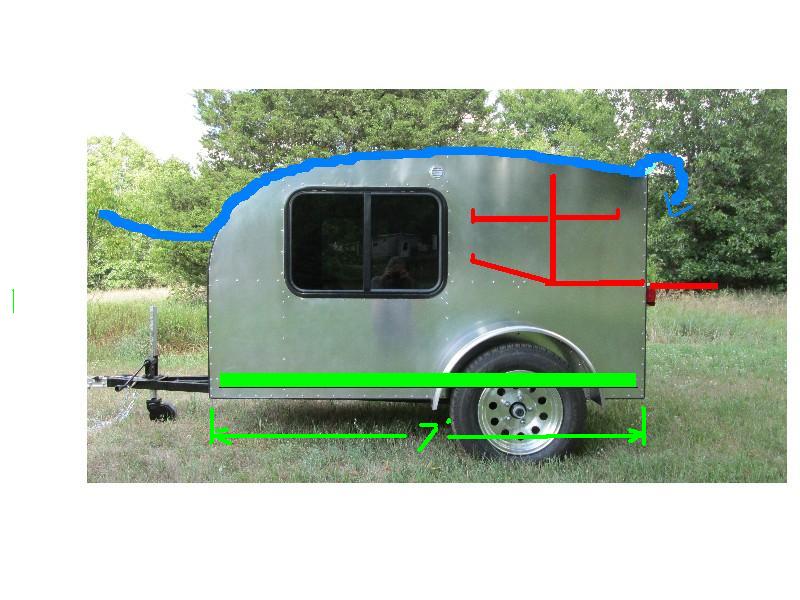

    Speaking of ideas, another friend suggested that I should explain the concepts behind the profile shape. Especially compared to the more traditional 4x8 retro streamlined teardrop shapes.
    The cabin is 7' long to reduce weight.
    Interior volume: The flat lower front wall & taller flat rear wall increase interior volume & bed length. The interior cabin space, bed length, storage shelving & footwell are quite generous. As is the galley with the work surface tailgate down.
    Aerodynamics: The lower front wall really doesn't matter, because that portion of the front is always within the slipstream of the tow car. The only way to improve this would be to round the front corners & blend them in to the curve of roof with compound curves.
    As the tow car & trailer move through the air, the trailer strikes the air coming off the top of the tow car. The more rounded the top front, the least the resistance.
    The blue line represents the boundary layer of that air. As the roof slopes down at the back, the boundary layer is released creating a vacuum that causes drag & lowered efficiency. By keeping that slope at a shallow angle, the boundary layer doesn't release until the very back.

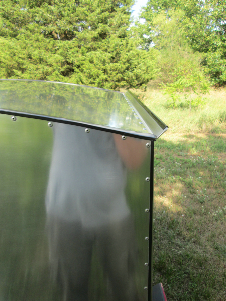

    At that point the flip up at the back strikes the boundary layer & turns it under, helping to break the vacuum & drag, increasing efficiency.
    The flip up is my version of the Gurney Wicker. So called because it was developed by American racing driver & Indy car builder, Dan Gurney.
    Of course, I have no way of testing my theories other than towing the trailer down the road at high speed (which I have :whistle: ). However, combined with a suspension matched to the load of the trailer & the large radial tires rated at 1356# & run at 21 psi., the trailer rides smoothly & handles well at speed.
    :peace: Fred
