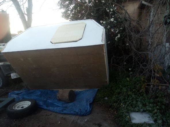

Postby saywhatthat » Tue Jan 09, 2024 1:10 pm
as you're doing a squaredrop why not a fiberglass panel? no water. no time-wasting frame? If the gap is not that tight no big deal. 50% are more faster to build .lighter.
Harder to tie a shoe than the trailer build. If any damage a few bucks to fix. Under $100 in tools . Too build. Just need panels. DIY fiberglass angle, glue, pop-rivets. A few can foam to blow up the seams
The glass angle on the outside makes the frame. with the 2-inch wet lay up on the inside part of the frame then you fill the gap with can foam makes a strong flexible frame for hard inpack. To build. Cut side profile . tape top panales in .Add angle outside glue and pop rivets on . Can remove rivets after glue drys . Do a 4inch wet lay-up inside seam then fill with can foam
IMG_20220110_163942 s.jpg (42.23 KiB) Viewed 1909 times
