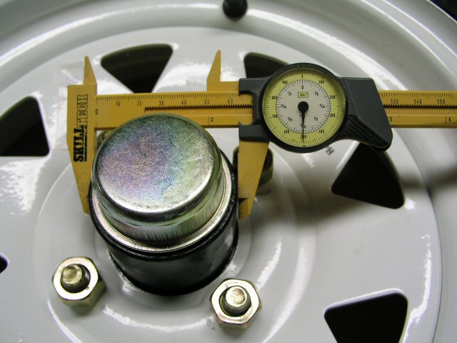

Can you by chance measure the center of those 12" HF wheels and tell me how wide of a hub will fit?

Postby mikeschn » Wed Mar 01, 2006 9:08 pm
Sure BG,
I looks like they've got a 2 1/2" hub stuck in there, and not much room for anything more...
Postby bg » Wed Mar 01, 2006 10:08 pm
Oddly, the hub on the 3500 lb axle I plan to use is 2.5" as well.
Thanks.
