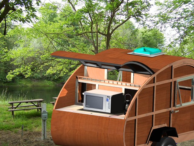

Postby mikeschn » Thu Mar 02, 2006 6:00 am
bg wrote:Alright, So I just had an idea about the hatch, It'd be small, but I certainly have the metal to do it. I'll play with it in the morning.
Would that galley be big enough for a microwave oven?
Postby mikeschn » Thu Mar 02, 2006 6:04 am
raru wrote:is it possible to have a full hatch like a cub, or is necessary to keep it as is for rigidity? that would probably be the only variation i would try to do...
Oh sure, you could bring the hatch all the way down to the floor. But you're going to give up a lot of storage space if you do it that way...
Instead of being able to fill up the area under the access lid with lots of stuff, you'll only be able to store stuff that fits on a 5" ledge, and that stuff will have to be able to stand on it's own, while you get the hatch closed.
Oh yes, you could build some fancy cabinets that angle out from the bottom, but now you are not ultralight any more...
Postby mikeschn » Thu Mar 02, 2006 7:48 am
BG,
Here's another option for you. I replaced the campstove with a microwave. Now you just need to fill your cooler with hamburgers, to warm up in there.
Good thing you got power at that campground! :Flippin Burger:
