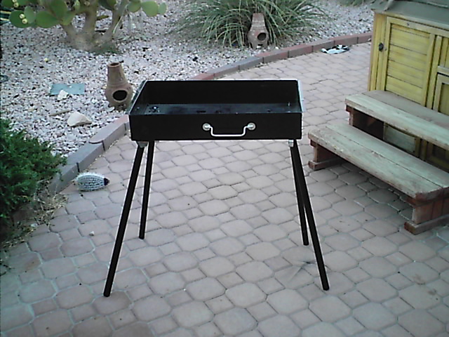

Postby daveleb55 » Sat Sep 29, 2007 9:48 pm

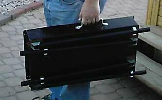

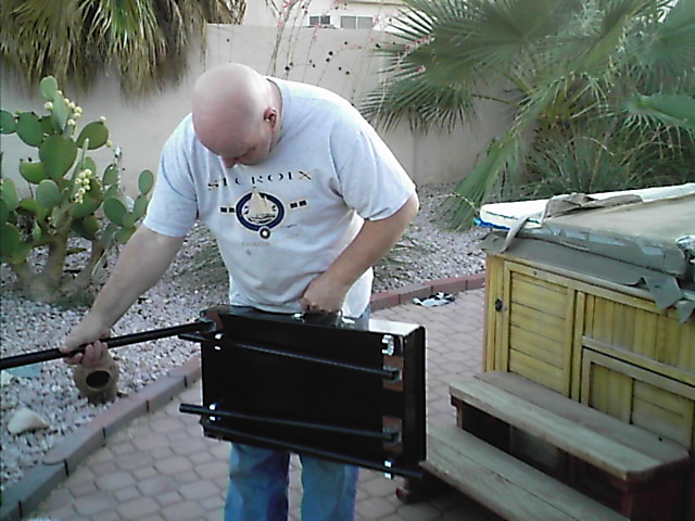

The table is just right for cooking, it's portable, and except for buying some screws to put it together, it was completely build using SALVAGE from the trailer.
Now, just pull out the legs like this....
Voila! Ready to cook!

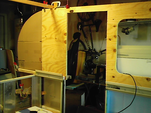

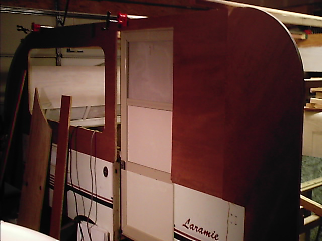

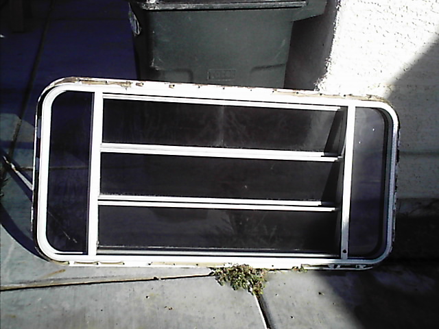

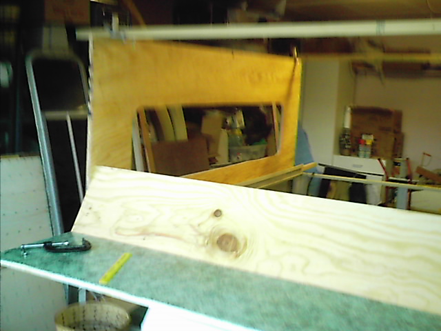

got some stuff done on the inside. Started cutting out the walls and making holes for the windows (salvaged some nice windows from a junkyard).
After having read about many different techniques, I have decided to laminate 3/4" ply between two sheets of 1/8" Luaun, epoxy fill and seal, and paint. Lightening holes will be filled with 3/4" foam insulation, 1/2 stringers across the roof will tie it all together.
I cut down the door to fit, aluminum angles will attach the door permanently to the trailers lower frame. A 2X2 running along the top of the aluminum frame will tie the walls to it. The 2X2 will be screwed to the frame from the inside. The plywood sections will be attached with a biscuit jointer, the galley counter and galley bulkhead will be joined to the sides similarly.

DaveCo presents the portable DO table just right for those weekend cook outs. It comes complete with the table, attached handle and four fold down legs. But wait, if you order now.... :lol:
daveleb55 wrote:The table is just right for cooking, it's portable, and except for buying some screws to put it together, it was completely build using SALVAGE from the trailer.
ImageVoila! Ready to cook!
Hmmm, that dog is just the right size!!!
:D

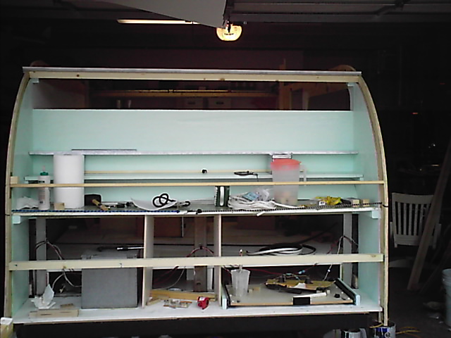

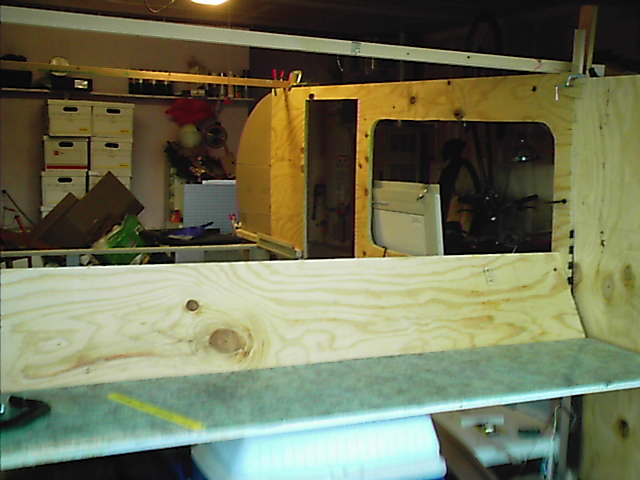

Postby daveleb55 » Thu Oct 25, 2007 4:40 pm
Here's a few pics:

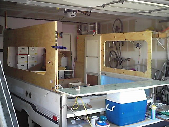

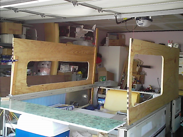

Outside view. The walls are now attached. I still have to extend the rear to make room for the galley. I add about 20 inches or so, go all the way out to the bumper. The floor gets extended as well. Biscuit joints hold it all together.
Inside view of the same wall. You can see the cardboard profile for the front. Because I'm installing a 24" tall window in front, the top curve radius needs to be reduced to around 14", else the tongue box will almost completely cover the front window.
Although it's hard to see from this photo, we actually found a guy locally who could cut a very thin slice of marble, which we laminated onto 3/4" ply, making a real marble countertop in a trailer!
Here's another view of the galley "mockup." Nothing is permanently attached yet, this is more of a "dry fit" to make sure I haven't screwed anything up. (Let me re-phrase that: "haven't screwed anything up to the point that it needs to be re-done!)

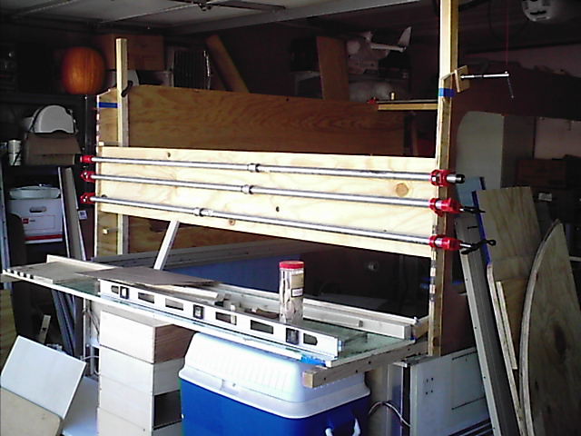

Postby daveleb55 » Mon Nov 05, 2007 10:32 pm

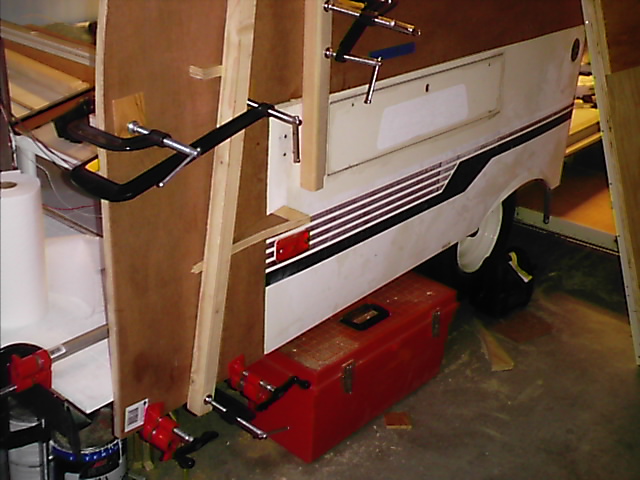

Making progress, slowly but surely. Everything is a puzzle that needs figuring out. I have been forced to adopt the "Making it up As I Go" method, since none of my original plans seem to be working for some reason or another. I spend a lot of time planning and measuring and figuring, then I try a "dry fit" and discover that none of the assumptions I made about this particular part of the build are turning out as I expected. Back to the drawing board!!

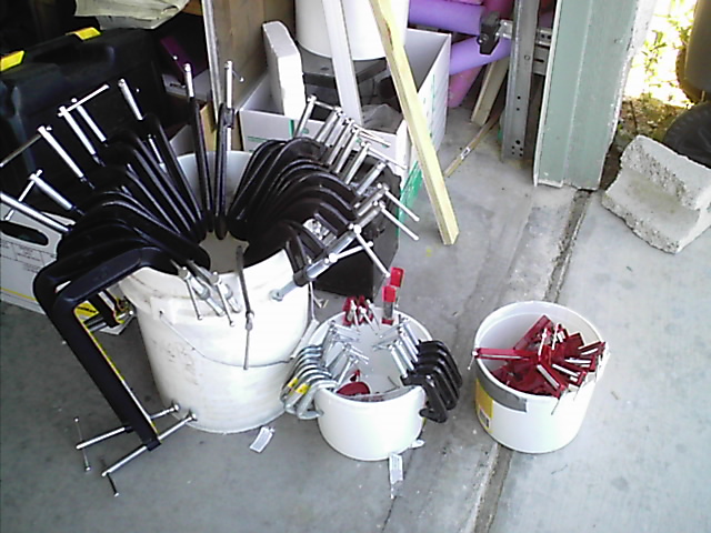

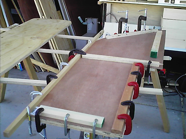

Clampus Maximus. This is laminating the luaun skin to the 3/4" ply.
Pipe clamps were on sale at Harbor Freight just in a nick of time!

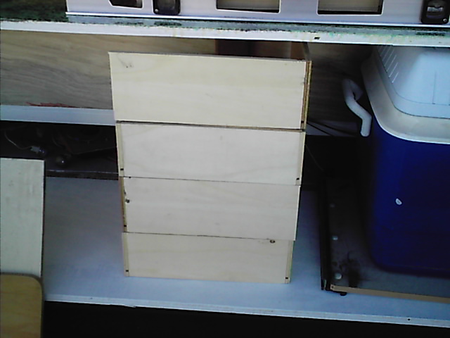

Fixin' to build some drawers. These were salvaged from the popup and cut down to fit the new galley.
More freakin' clamps. Think we got enough now?

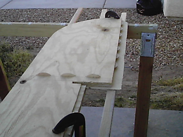

row of biscuits for extending the floor out to the bumper.
closeup of the biscuits to join the side wall extension
Clamped and glued: the sidewall rear extensions form the space for the new galley.
The extra 2X2 and wedges are to straiten a bow in the plywood.

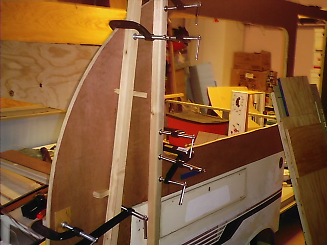

Postby daveleb55 » Mon Dec 03, 2007 9:50 pm
work continues but at a painfully slow pace. Every step is a puzzle to figure out, and everything is taking twice as long as I originally anticipated. I blame Murphy!! Here's a few pics:

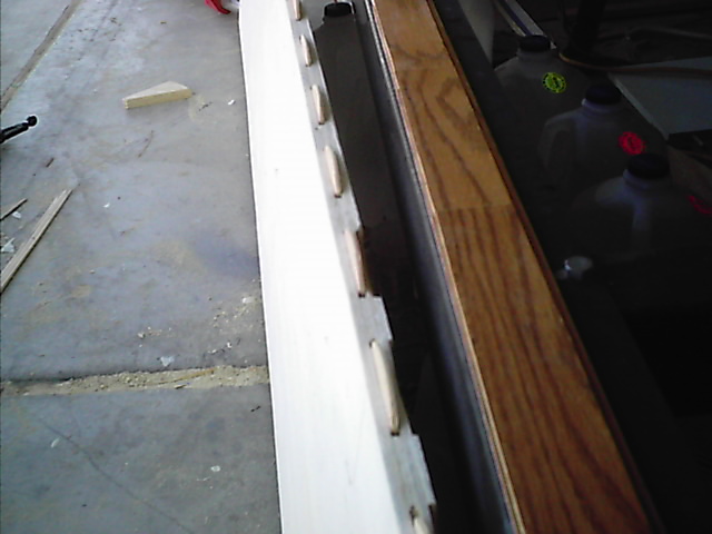

Lining up the biscuits for attaching the front wall extension. Notice I'm biscuiting in two axes, and then final fit with a rubber mallet. Then I clamp the heck out of it.

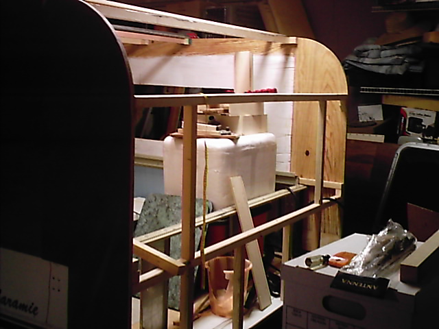

Here's the front framing in progress. The center opening is for a window.
Galley view, and hatch beginnings, although the hatch is hard to see.

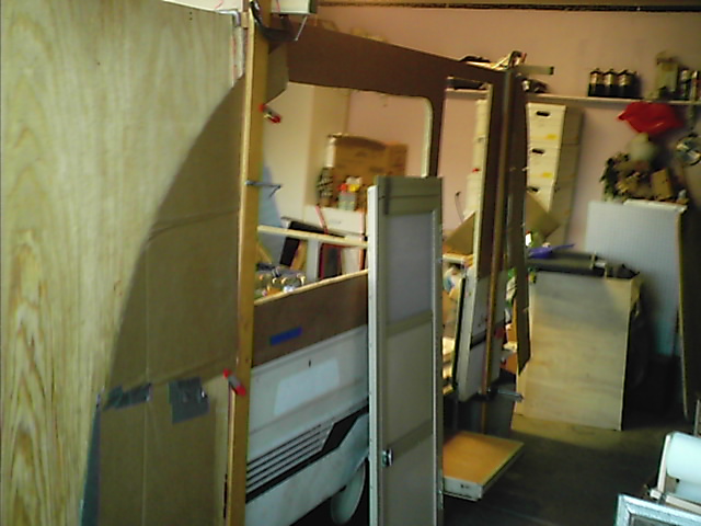

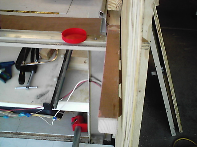

Here's a side view with the end extension in place. I've also mounted the cut-down door, and started some of the wiring. The original wiring harness is kind of rough shape, especially where it was exposed to sun and weather for ten years, so I may wind up replacing the whole shebang
