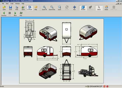

Here's a link to a *.ZIP file for Lester's Nest'r...
http://steelcharm.home.twave.net/LestersNestr_Multiviews.zip
In it you will find the same file as an *.EXE (A program). This is a program AND file together... an E-Drawing and a the E-Drawing viewer.
Run the ZIP - extract the program - run the program.
It looks like this...
It should be pretty self explanatory.
Enjoy!

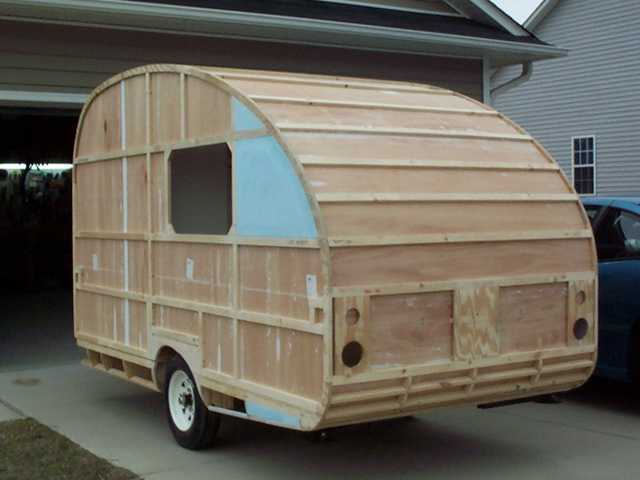

I added a few more pix to the gallery, and managed a bit more progress; added some blocking for where the running lights will go and added the backing plates (plywood) for the tailights and tag.
Gallery:http://www.mikenchell.com/forums/album_personal.php?user_id=5360
I also finished the rear roll-pan framing and the rear quarter framing.
I rolled the whole thing outside again and turned it around (cleaned the garage) and moved her back in. It was an overcast day but about 65 degrees - gotta love that Fayetteville 'winter' - (summer's maybe not so much!)

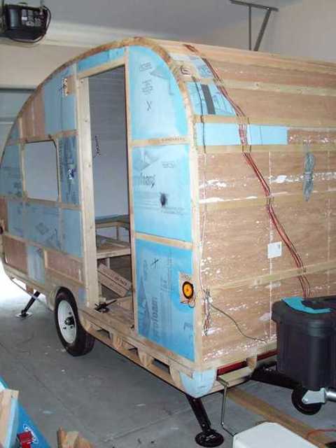

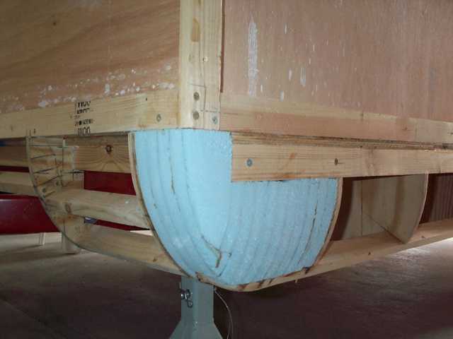

The Nest'r now has landing gear! and I'm off the jack stands.
I have "solved" the compound front corner issue. (I think) :thinking:
At least the underside has some support.

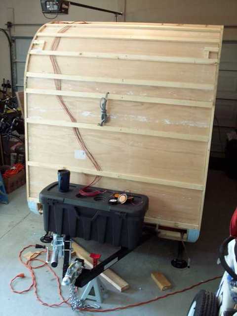

The wiring for interior accessories and lighting is now in. I ran 16ga wire to support two accessories at a time; the wiring runs back to the tongue box. -- Yes, my plan is to have the battery on the tongue. The extra weight should not be a big deal -- hopefully!
That 'tongue box' is really a small plastic toolbox from Lowes, it was just the right size, and I don't have to construct one now!

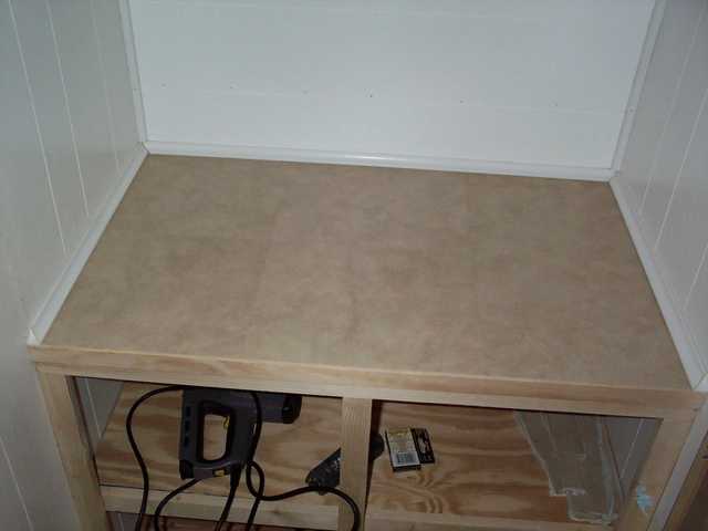

Oh, yeah the counter top is covered and trimmed out...
That's sticky-backed floor tile - cheap solution! 8)

I've begun to install all the insulation. I want to see it "wrapped" some time this century!
