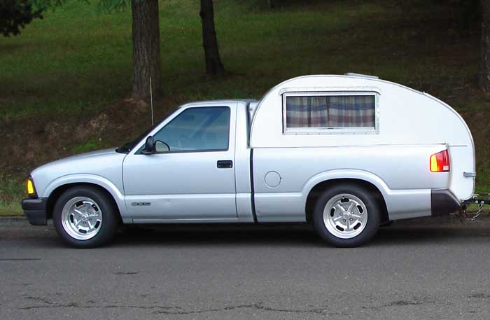

Postby mikeschn » Tue Apr 01, 2008 3:55 pm
Remember this one?

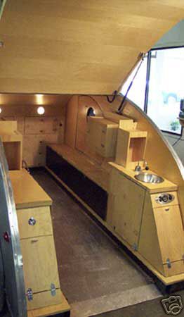

Postby mikeschn » Tue Apr 01, 2008 4:13 pm
the inside could be fashioned a little bit like this one...

mikeschn wrote:Remember this one?
Uhhmmmm ... :thinking: ... yeah ... :thinking: ... maybe ... O.K., sure ... :D ... that shell does look kinda familiar ... :lol: ... :lol: ...!
Nice bit o' photoshopping, there ... but I think I would have raised the tear-box up about 6" and then lowered the window(s) about 8" (so you could actually see outta them from the cab).
Ya know ... I used to build camper shells and bed-conversion kits for pickups, and I've had a couple of my own that I camped in and out of for a number of years, but IMHO, there's just no comparing them with a full-on teardrop trailer! Pretty nice & secure place for the kids, though, while Mom & Pop take the TD (or for Gramps & the dog when Gram & the grand-daughter lay claim to the 'Drop ... ;) ...!)
Always did like the lines of that particular series of S-10/S-15s ... even though they are GM ... :roll: ...
